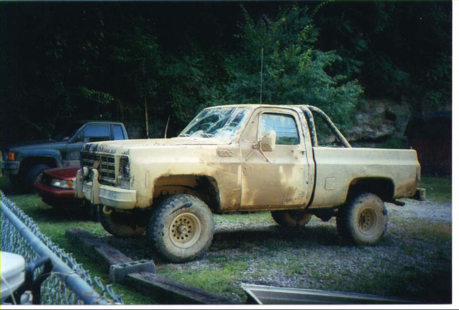

To post pics click "Manage attachments" below where you type your post and upload them there. Then click the link for the pic, copy the url, click the little picture thing above where you type your post and paste the url there. Here's a pic of my K10 on 4" lift/33s, if you quote the post you'll see what it should look like...
attachment.php
2" lift might put the tire too far in the fenderwell, if you take it offroad you might rub. 4" gives you a little overhead to go with 35s down the road if you want.

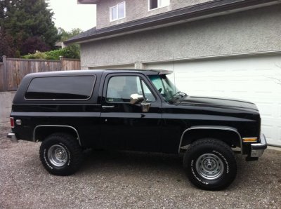

So here she is, as you can see the back is a little low.. only by 3/4". I still think ill stick to a 2' because for now i really wanna stick to the 33's and just have a little lift. Has anybody used front shackles for a lift before?? there's some out there that'll lift only 1" 1/2 which im fine with and then get the proper sized block in the back.

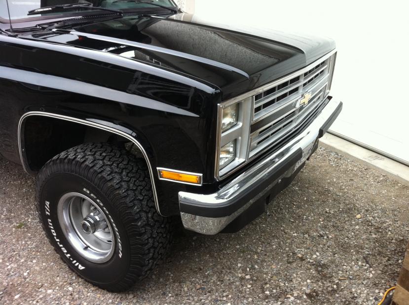

here's another picture..
Oh the other thing is i just measured all 4 corners and from driver side to passenger they are off a bit? what would be the cause for this??

Which is lower? driver's side or passenger side? Maybe a big ole boy owned it before you if the driver's side is lower, or maybe a PO had a big ole woman which would be why the passenger side is lower.

Haha well my uncle owned it for 95% of its life previous to me, and him and my aunt are not big for sure, so not sure why it would be off?? its lower on the drivers side, its not a real big deal to me but since i just measured it kind made me curious why

Maybe where he parked it every day was a little off-level, or if he was the only occupant for the time he drove it, even not being big the springs may have just worn that way. I think just about all trucks are a little off from side to side but I never let it bug me, it would have to be off by a lot to make me go to extremes to fix it.
