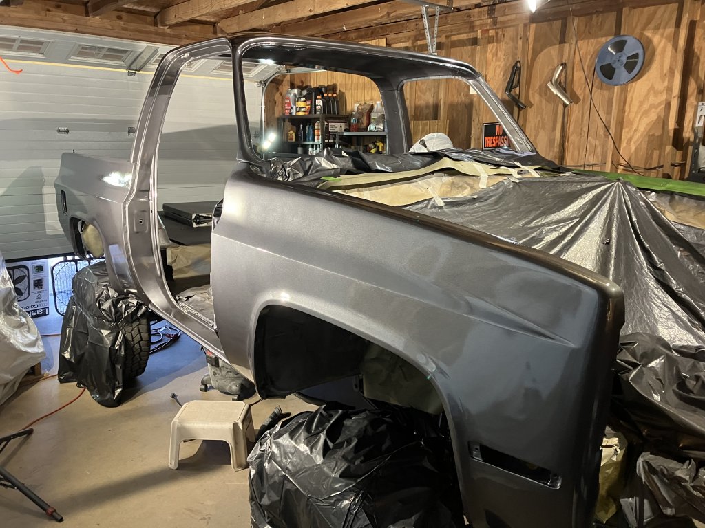

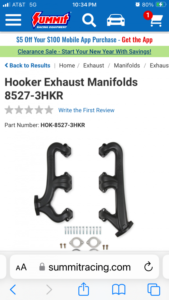

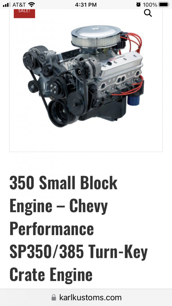

Soon to be installing a new crate SBC 350 into my restored ‘83 K5. I’ve decided to go with exhaust manifolds instead of headers but my question is how can I break in the new engine without having exhaust pipes installed that I’ll have to take the Blazer to to have the pipes installed? Or, should I trailer or tow the Blazer to the exhaust shop before breaking in the engine assuming the shop won’t need to start the engine/drive it into the garage and onto the lift? What would be the best course of action? Thanks!
