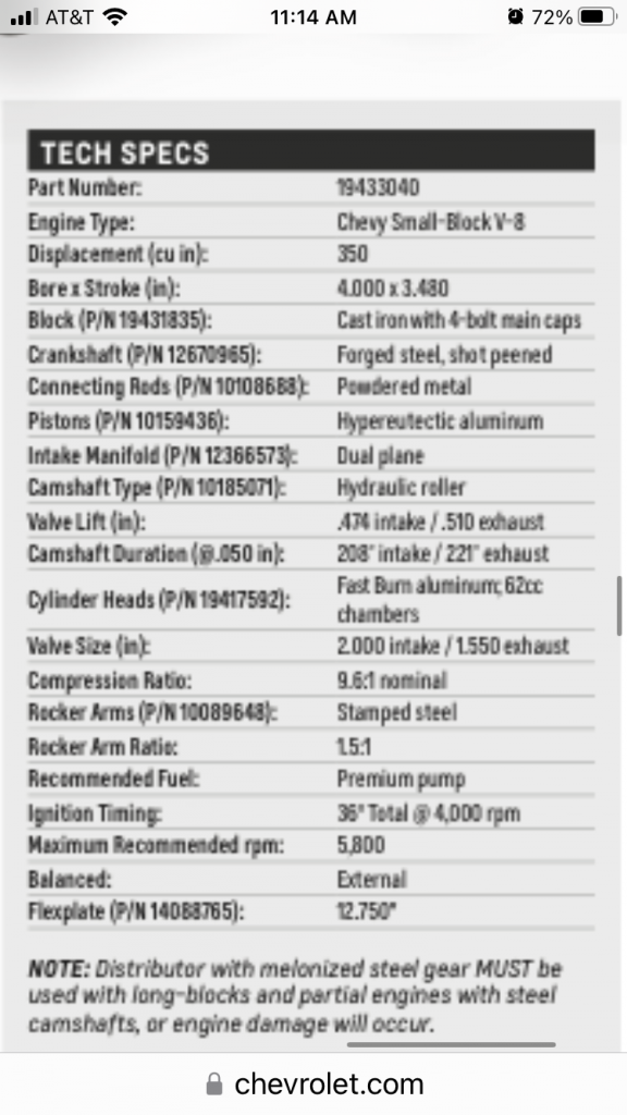

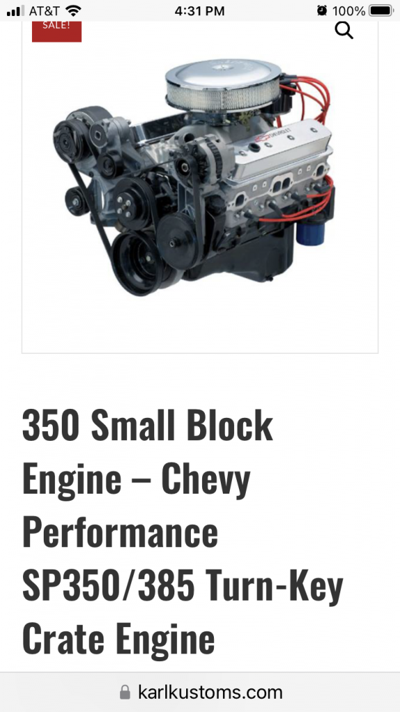

I didn’t receive any responses to my previous post for the same subject so I’m posting again in hopes of finding someone that is running the same or similar configuration that can tell me what aftermarket headers or exh. manifolds that they could recommend for my ‘83 K5/4” lift/4WD/new crate SBC SP350 w/“D” port heads and angled plugs engine that I’ll soon be installing that won’t cause any fitment or clearance issues. I’ve heard that some headers interfere with the front driveshaft but I can’t imagine how. Thanks!
