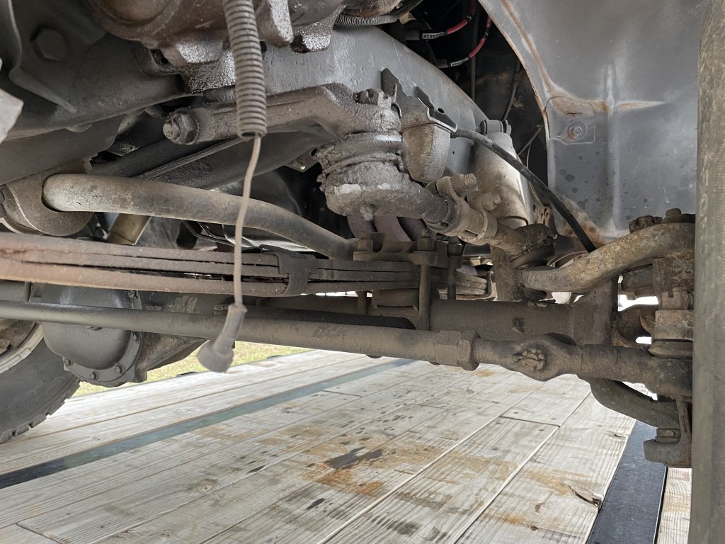

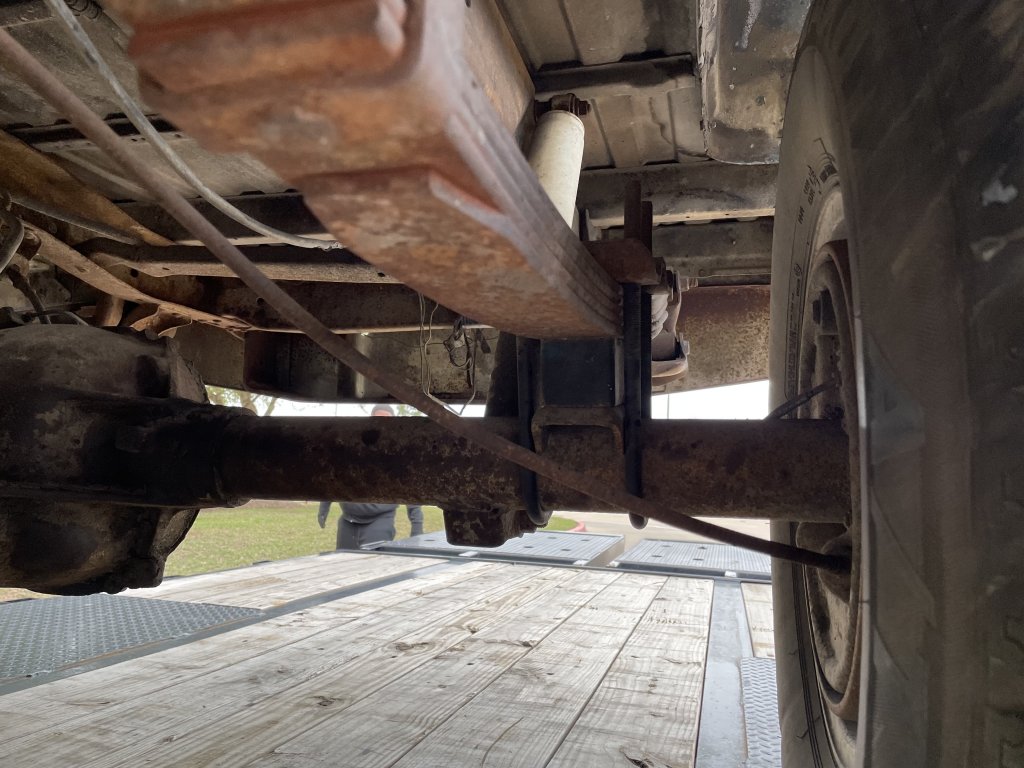

Thanks everyone for the feedback, I know it’s been a couple of weeks but I finally got the trucked picked up and brought home! Been excited about getting to work on it with my son. I was able to get some better pictures now on the front and rear leaf springs. It seems there’s a block on the rear leaf springs and the tires on here are 33x12.5. I like the height bc it just fits in my garage and I like the size tires on it. So I’m order to level it out, I need to determine if those are stock springs with a block in the back and if I wanted to keep the rest height and match the front what my best option would be!
