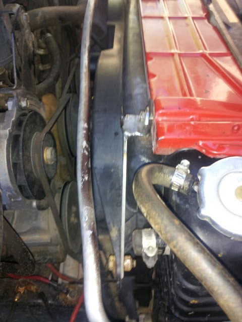

Top plate ull need to find... heres pic of mine

OK. Here's my 17 x 28.5" (core size) radiator with the aftermarket 2-piece shroud I bought. I have some heavy duty metal clips to hold top and bottom halves together, and will come up with something like L-brackets to secure the bottom half to the core support. Looks like an 18" clutch fan will fit smack dab in the middle of the 20" circle, and protrude 2/3 in and 1/3 out. Didn't have to trim a thing! I'm happy.
