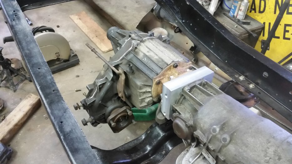

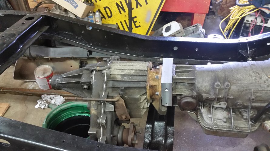

Well tc is all mounted in its new home.

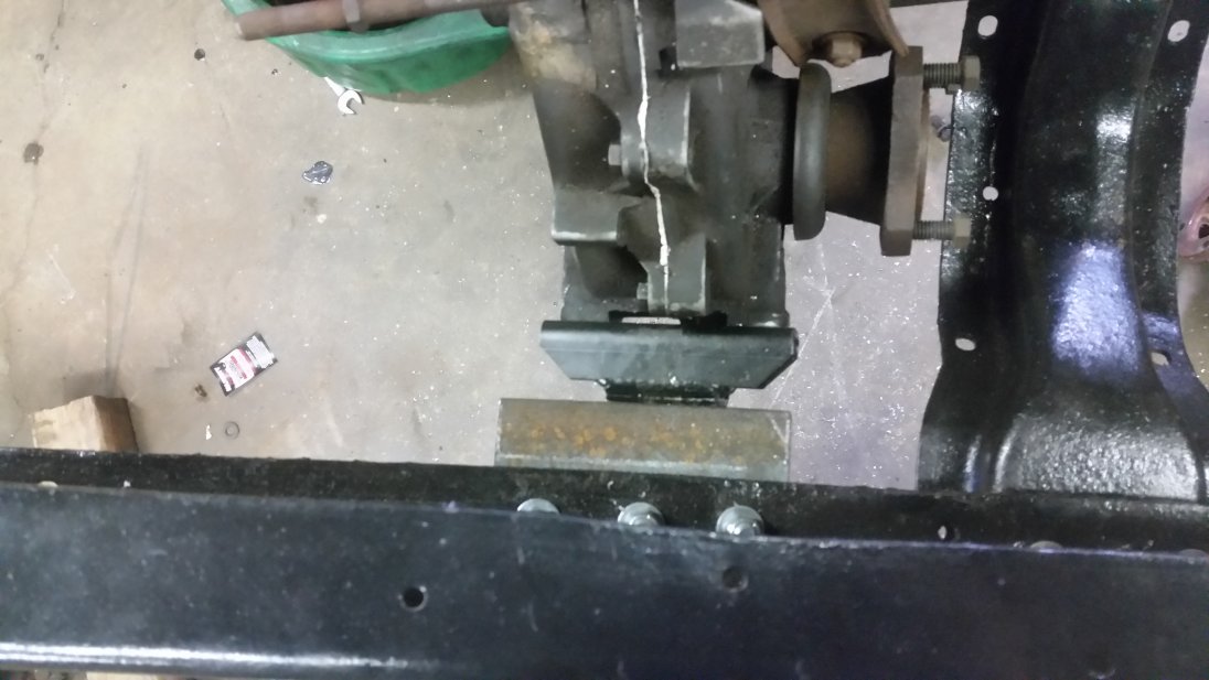

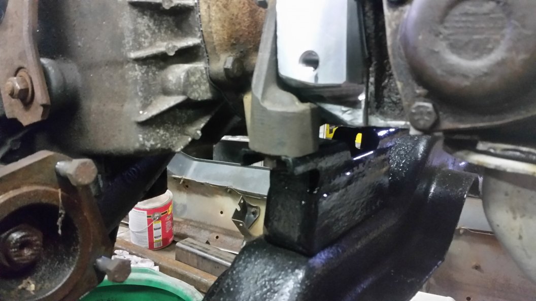

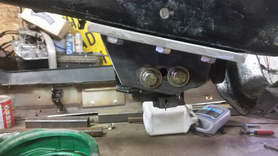

Decided not to extend the factory torque arm. Used a solid trans mount i had laying around and a 3/8" piece of angle. Everything is solid mounted so this just completes it.

Solid engine mounts too I assume?
What concerns me is frame flex, GM designed them to move around. Think it will be OK?

Yes solid engine and trans mounts. From the cab back the frame is plated with 3/16" plate. This is more or less a mud truck that is street legal to run in the street class.
