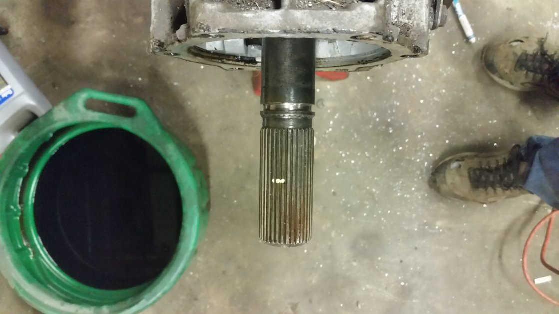

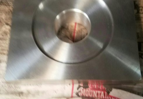

Ok so i found a 208 with a 32 spline input and adapter. Opened it up wasnt completely satisfied so i pulled it apart and swapped input shafts with the 27 spline unit i had from the truck. Only to find out the out put shaft on my trans is 1 and 5/8s inchs to long. Its a 2wd th400 out of a 1 ton van. (Bolt on yoke). I did alot of internal work to this trans and it worked well in my Chevelle so i want to reuse it. (I had a special slip yoke made for it to work in my car.) Any way does any one know does any one make a spacer to take up this space or do i just have it machined?
