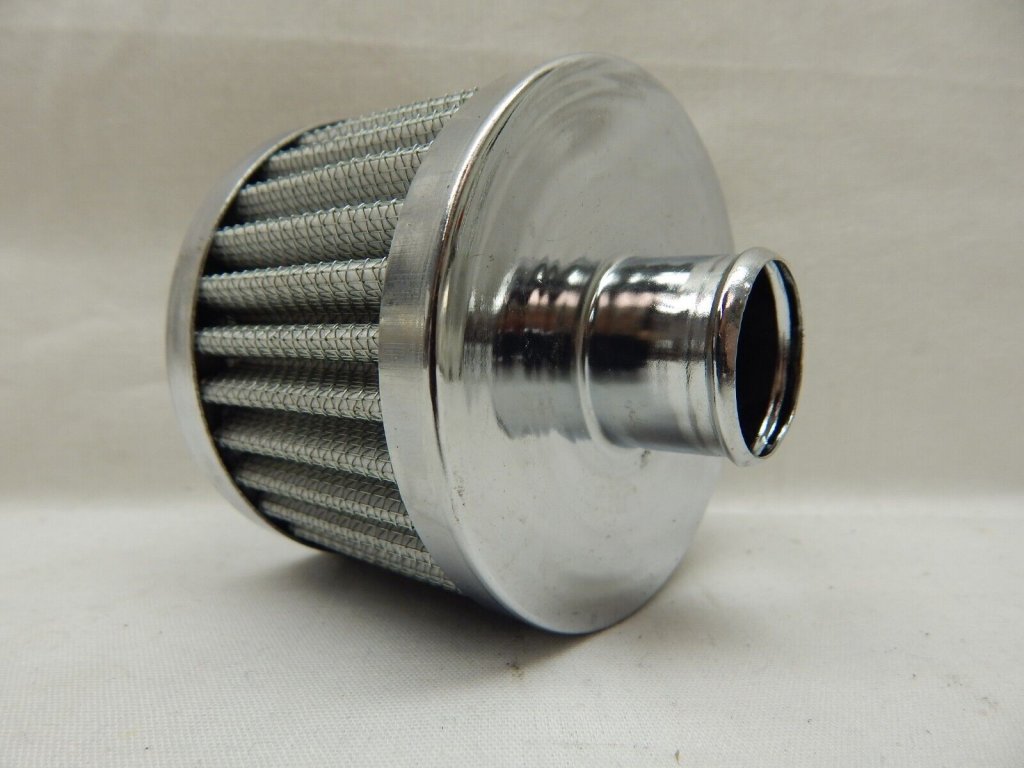

If all else fails:
10,175
19,683
I am restoring my 1987 V3500 with 7.4L TBI engine. The breather pipe disintegrated into a pile of plastic. GM discontinued part #14103133. I am keeping this truck stock so I don't want so goofy looking Mr. Gasket breather. I just need ideas to make something that looks decent and fits the grommets and the hose nipple on the Air Cleaner.
The grommet is made to fit a 1/2" tube.
The item I need to replace is #1
I'd bend something out of steel tubing,just like a brake line a fuel line or transmission line. If I didn't think I could do it in steel I'd do it in soft copper,or pex I'd paint it black when done. Push comes to shove you could use a piece of pcv hose the correct length put a spring inside it to keep it from collapsing.. it won't have a nice 90 and 45 but you could make a sweeping C shape you'd still need something,maybe a copper elbow,plastic elbow at the valve cover
