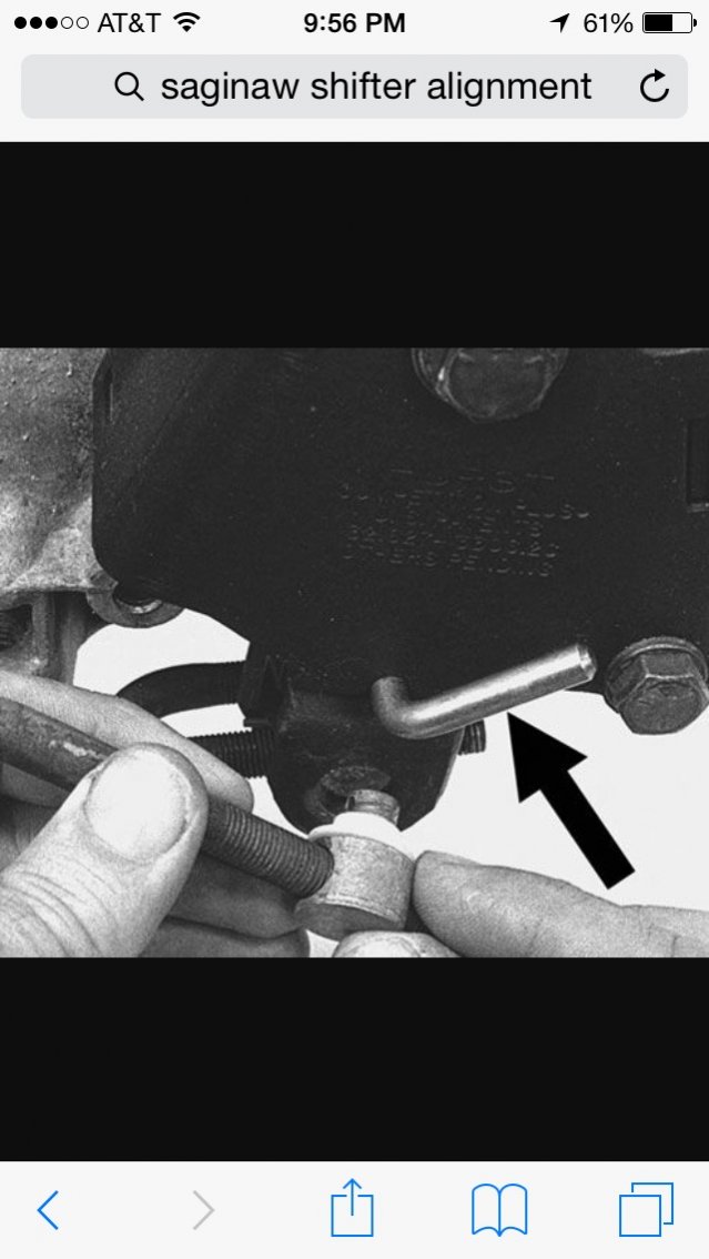

I guess you'd call them bushings, but yeah, each shift rod has the metal "tab" that is attached to the tranny with the nuts. Each of those is present and seem to be secure without excessive slop or play. I'm wondering if maybe I "reversed" a tab (installed pointing up vs. down) when I reinstalled the shifter / shift rods?
I was smart enough to take a couple photos of how the shifter looked installed prior... so I get points for that right? The OTHER half of that prep work you need to do before tackling a job like this... check that you can actually SEE the parts clearly or your greasy finger hasn't smeared the camera lens on your phone. :whymewhyme::bawl:
In other words kids... when starting a project, take before photos, CHECK said photos actually show the before, THEN proceed with the removal!
I know this shifter needs a rebuild.. that's coming, but I lean more toward incorrect installation as it never exhibited this before the clutch job. I unbolted the shifter from the tranny, but never opened the shifter itsef so I don't think much could have changed.
Also... what do you mean by "realigned the shifter using a pin through it"? Is there an alignment / adjustment procedure to installing those?

If you installed an arm backwards the gears would be in different locations unless they are straight and not offset then technicly you could get them wrong if the slot is not paralell with the arm. Alignment is done witha 1/4" rod through the shifter as seen in the pic.
