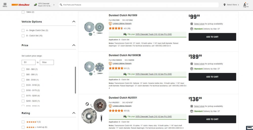

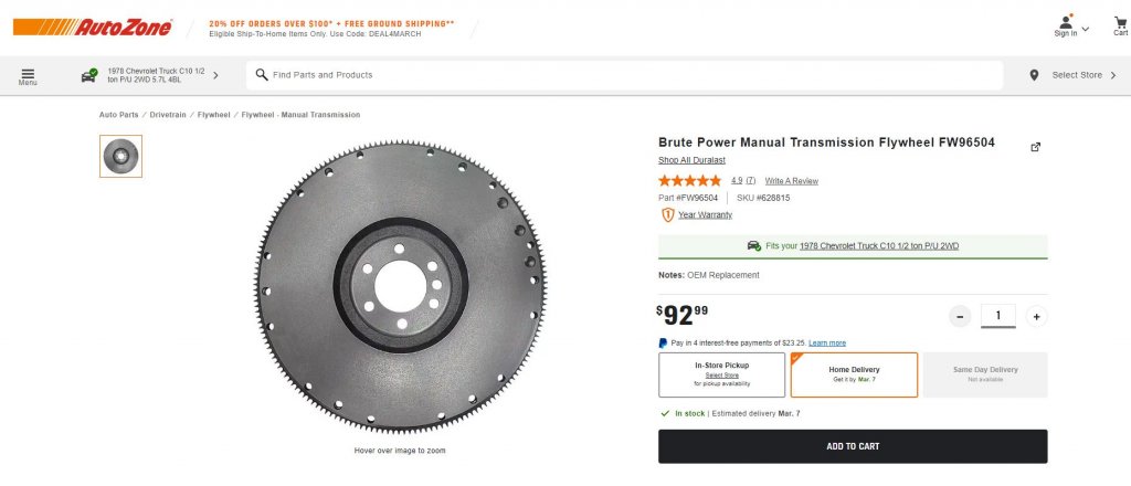

Hello all, it's been a while.
I need help figuring out which clutch and flywheel I need for my truck. I don't have it out, and I don't want to play the return/exchange game. I'm letting a shop do the clutch job because I've only ever done a clutch once, it was nearly 20 years ago, it was on an old VW Bug, and I wasn't alone. I'm not brave enough to try this by myself on my back under the truck with no help or even anyone to call 911...
My goal is to order the parts to save a little money at the shop -- they quoted $400 in parts.
AutoZone and O'Reilly both have a few size options.
My 78 Big 10 has a Muncie SM465 mated to a 350.
Thanks!

Your truck is pretty standard equipment. An 11 or 12 inch clutch will work. Please buy a "clutch kit" so that you get the correct associated hardware, specifically the correct throwout bearing. And don't forget to replace the pilot bearing/bushing while your in there. SB's are standard size, .590.
Confirm that you have a 153 or 168 tooth flywheel before you order anything. Look at the starter bolt mounting configuration. If the two bolts are straight across from each other it has the small flywheel. If the bolts are angled it has the big flywheel. I'll bet $$$ it's the 168 since it's a manual trans.

Ok, so the clutch is either/or? I assume the 168 tooth flywheel is larger in diameter than the 153. So wouldn’t I want the larger clutch in that case?
Not really. I have a 168 and an 11 inch clutch. An 11 inch is more than enough for 90% of daily drivers. Some 12 inchers may interfere with the inside of the bellhousing. A 12 inch will not fit inside my bellhousing. I only have about an 1/8th clearance in some places. It's not just the diameter, it's also the shape/depth that can cause issues. Also, most larger clutches mean more effort to disengage. That quickly becomes a PITA in stop and go traffic. This is a good example of keeping the "Bigger is better" approach in the bedroom. :pedobear:
