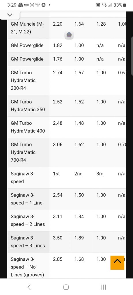

Look at your gear ratios. M21 would be downgrade for a truck that has to tow occasionally. A 700r 4 would make the truck tow better and have overdrive.A granny 1st 4speed and a steeper rear gear would cut your rpms and make it tow better. M21 will just be harder to take off and extra shifting. You need to widen the gear spread,not bring it closer together.

I don't think 1st gear is deep enough for your application in the M21
Came here to say this. Or at least, in some iterations, the M21 has a really tall first gear. Seems like the clutch would really suffer. Let alone take off power.

M21/22s have a 2.20 first, which would be awful for towing. Autogear can update the ratios, but that would soak up the 1k budget though
