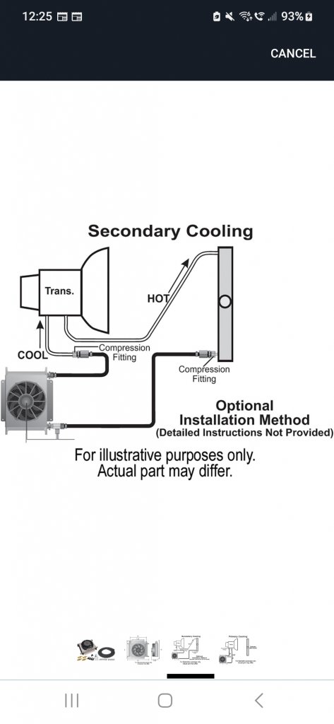

@Ricko1966
Yeah the kit ive got has a thermostatic switch to kick fan on at 185f and off at 175f if im not mistaken.
So, in your comment you mention going to aux cooler first, then back to stock rad, and back to trans.
Heres a pic off the kit, it does the opposite, stock rad first, then aux cooler.
because if we gonthe way you mention, the atf will be at the temp ofnthe engine coolant (or around there) taking into account efficient heat transfer.
And other way, itll be whatever thermostatic fan switch i end up installing (there are many availble)
I almost wonder if the gains in cooling at gained just by extra volume in the system. At which point, get a deep pan and finned for extra volume

Oops forgot to attach pics, my bad.

No they make a thermostatic valve to bypass the cooler below a certain temp not just turn on a fan. My gut says the cooler manufacturers recommend that routing because they can take an already cooled( by the radiator) fluid then bring it down some more even if it brings it below optimal. Guys that aren't thinking about too cold isn't good either can see the dramatic difference. Where as if they had been watching a gauge forever and thier temp was 195* and they put on a cooler and bit was still 195* then people would call thier coolers junk,they don't do anything.

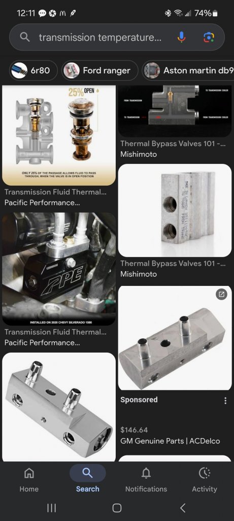

10,167
19,654
Yeah yeah i get what youre saying.
I dont doubt the efficiency of the aux coolers, I am concerned about winter though. Either I warm up the truck for 5 mins minimum before going anywhere or, I route it the way you suggest and the coolant regulates it at its designated temp.
It was all stock when I burnt out 3rd gear clutch pack though and it was end of September too when it happened. I'm still confused as to why that happened.
Geez I might look into a thermostat for my poor engine oil cooler, oil pump definitely won't like pumping molasses from the aux in january lol
I edited my last post to put up this Pic. They also make thrmo bypasses for oil coolers

Yep, I think I'll be safer with one of those. Otherwise next post will be how do I change blown up oil pump in the winter lol. Have one for trans too at the same time.
It's not uncommon where I'm at to drop down to where celsius and Fahrenheit meet at -40. Lok i jad the truck plugged in and at minus 40 it was not having it. At all.
Nice I appreciate the heads on the thermostatic valves. Hopefully the fittingd are compatible
