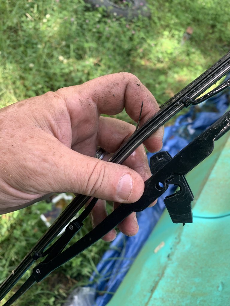

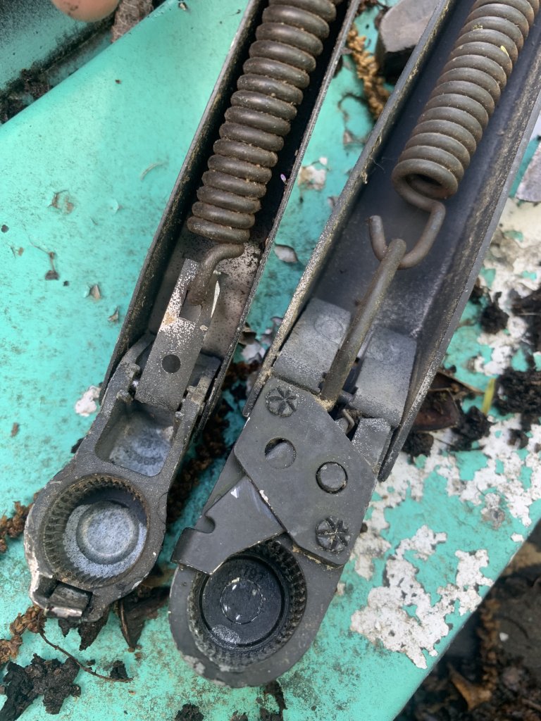

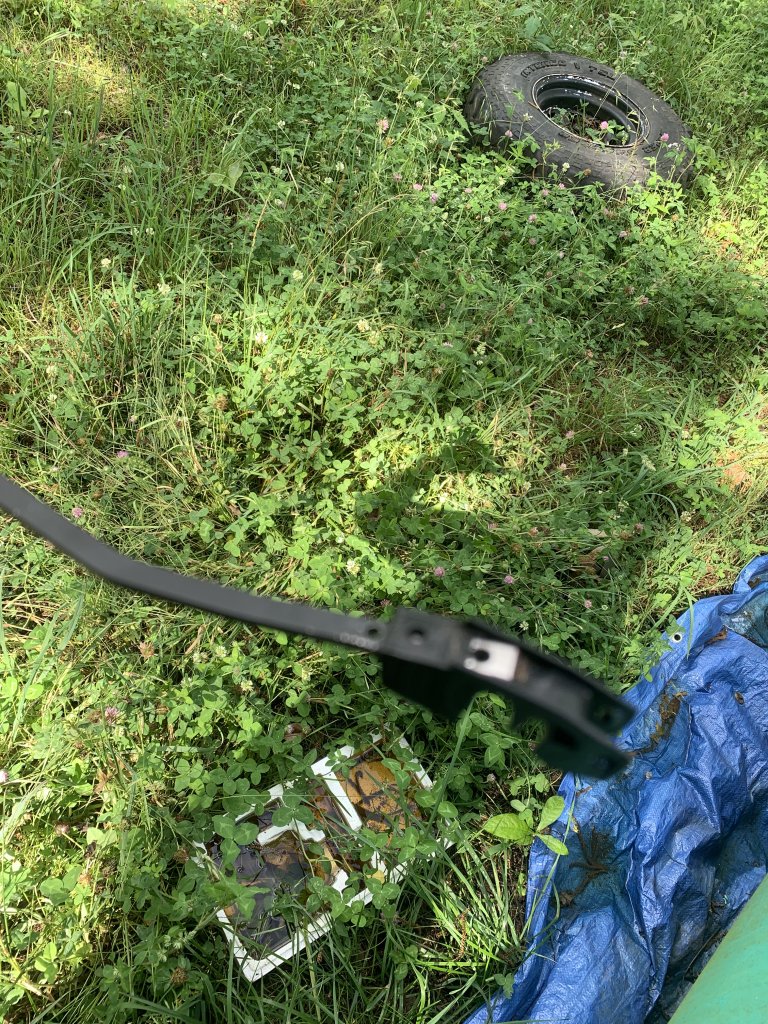

gmt400 fits driver side, not passenger side on my 85. So… trim off the pin box… wipers blades come with a multifit end…

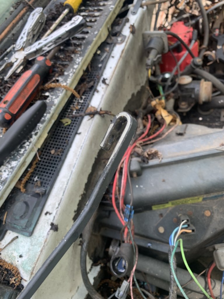

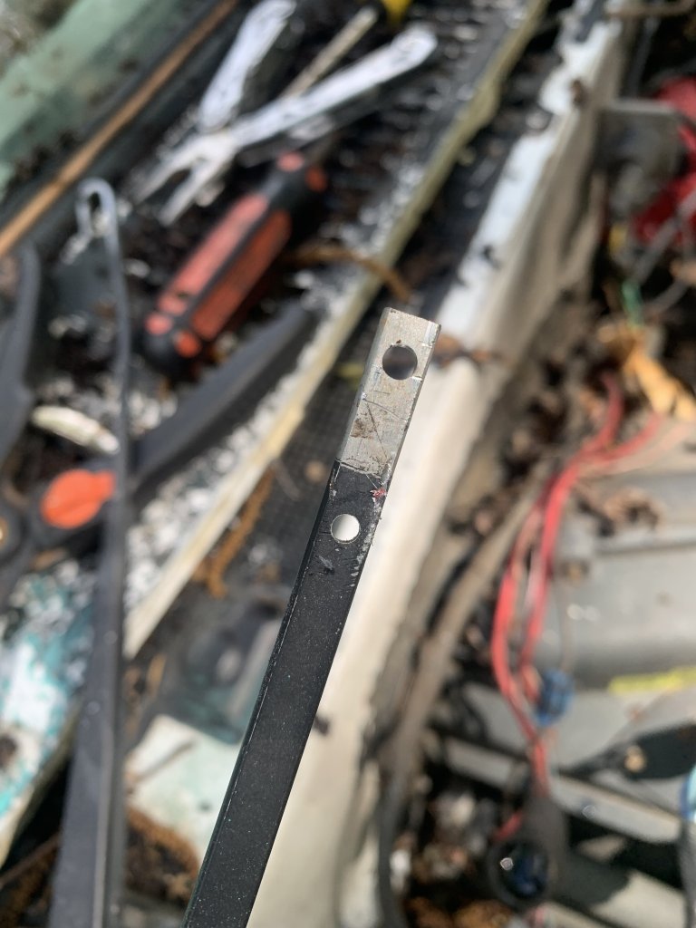

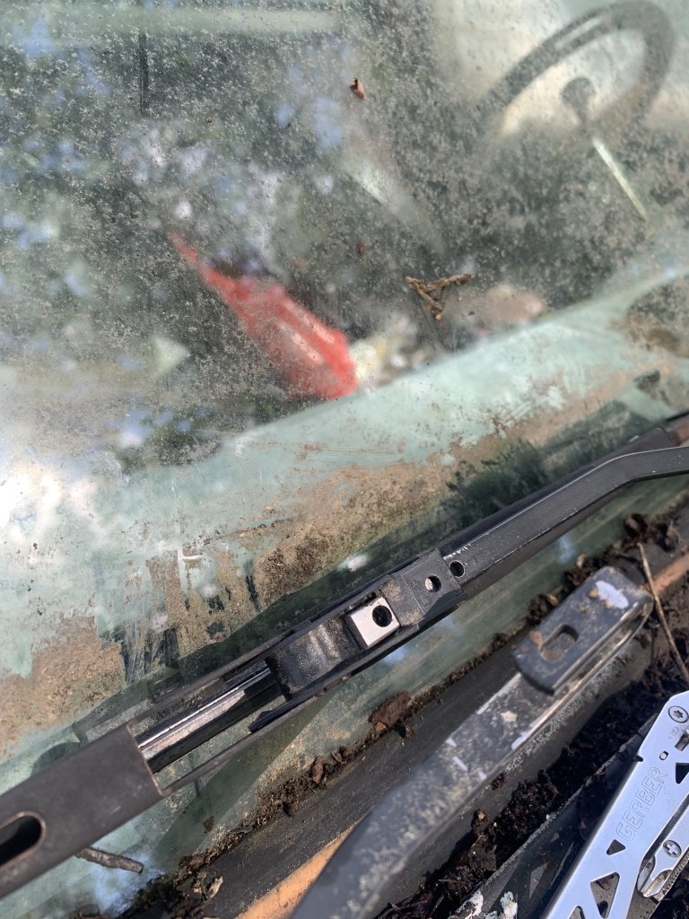

Looks like hell, works, takes 5 minutes
