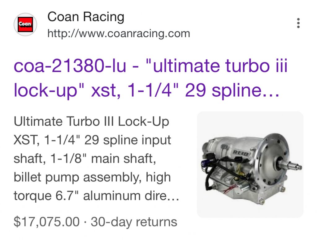

Either way I'm installing a lockup converter on the th400
How do you install a lockup converter on a 400???
I have seen the kits to modify a 400 for a lockup converter. It’s intended for big money class type racing, with huge by large, money is no object race cars.
The lockup converter kits cost enough to buy 2 gear venders, with money left over. It consists of a pump, input shaft, the hydraulics to make it work, and an extremely expensive custom made converter.
Nick88
Nov 19, 2024
82
31
New York
Nick
Blazer
Well let me rephrase, I shouldn't have called it a lockup because it technically isn't, what it is is a fuel miser torque converter by Hughes, it acts like a lockup converter by greatly reducing slippage and drops rpms a couple hundred rpm when cruising. Essentially a lockup converter but not technically a lockup.
Matt69olds
Jan 8, 2018
2,850
4,713
Central Indiana
GMC 1/2 ton
455 Olds
Ok, that makes sense.
FYI, you could buy 50 of those fuel miser converters for the cost of ONE lockup th400 trans!
