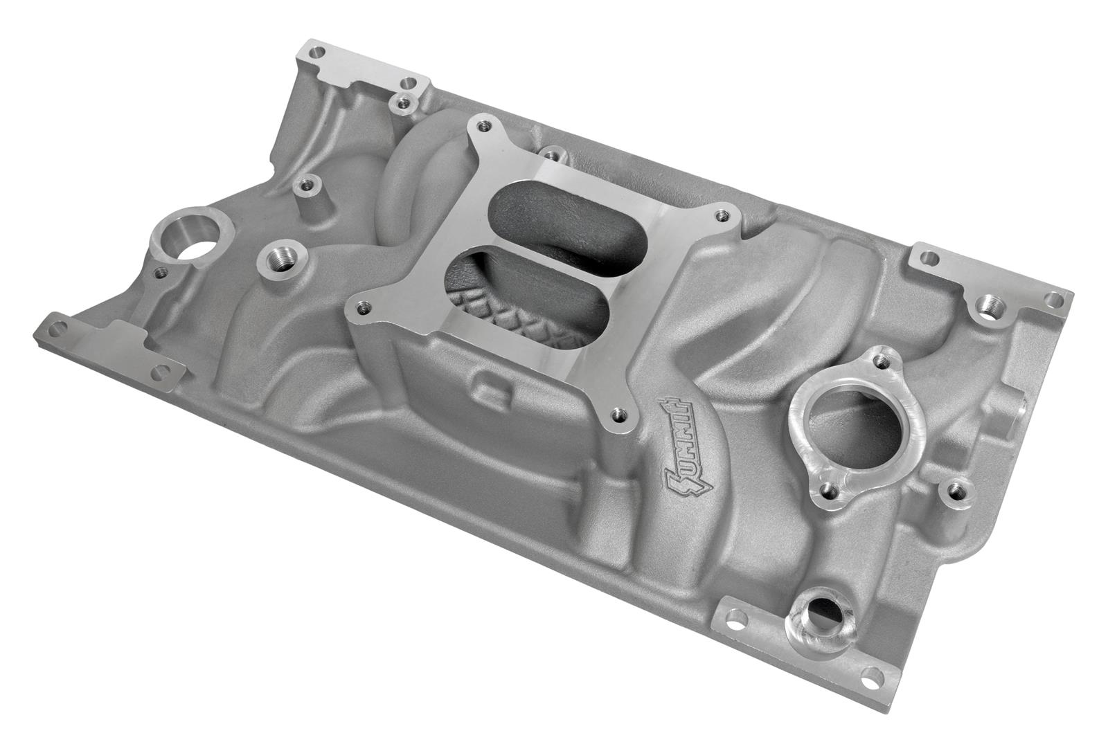

Vortec carb intakes are not that bad price wise.
