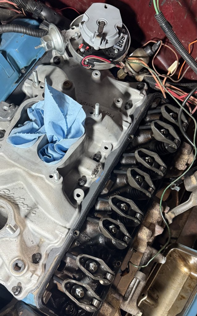

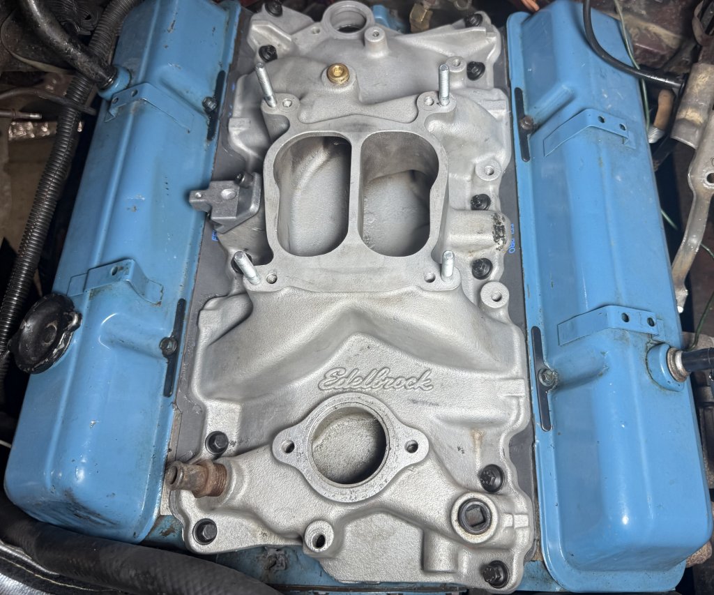

I ended up using the weather stripping adhesive again. I also ran across some arp intake bolts in the shop.
Had the shop running bout 70 degrees for about 6 hours today. Warmed up the intake in front of the heater for a bit. Running the heater that long may have cost me $50 in kerosene but that intake should be sorted.
Let the ultra black set up for 30-40min before torquing. Did it in 4 stages.
Because I used a swivel socket on the intake bolts, I added 3-4ft lbs to the final pass.
Pleased with how it went together.
As long as you got enough ultra black on the back like it appears you did on the front, the seal should be good to go.

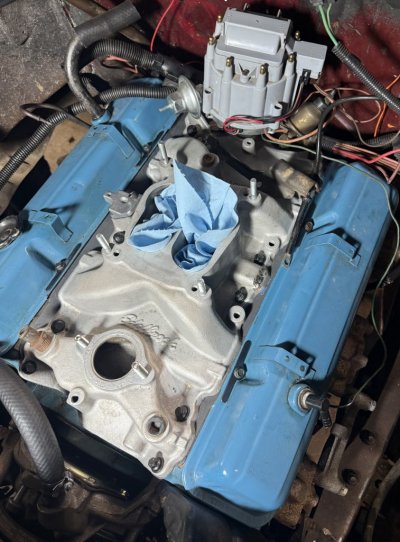

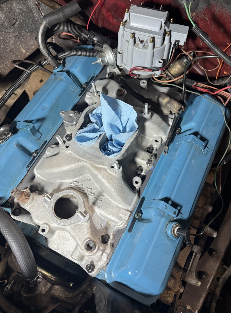

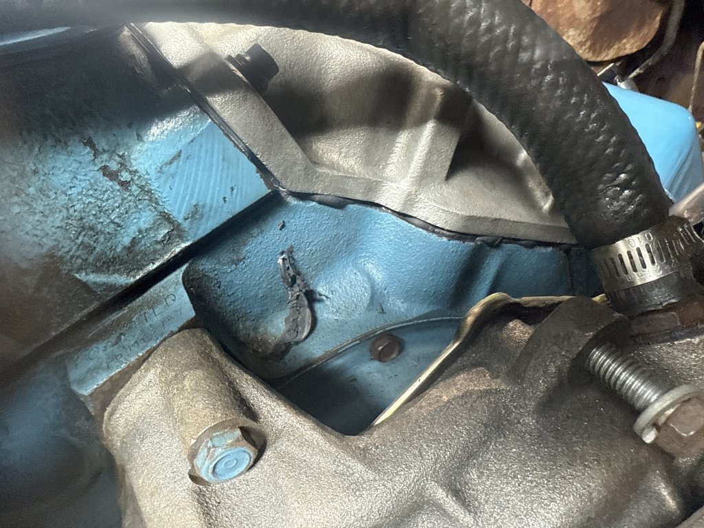

Got the distributor installed and cleaned up the shop a bit. Picked up the fluids and filter. Tomorrow should be go time…
