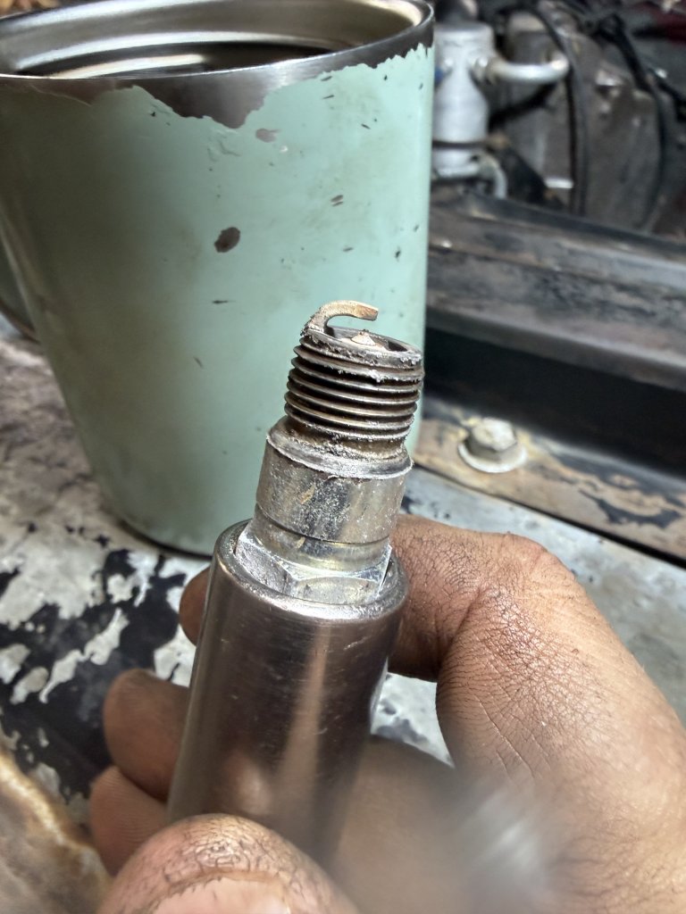

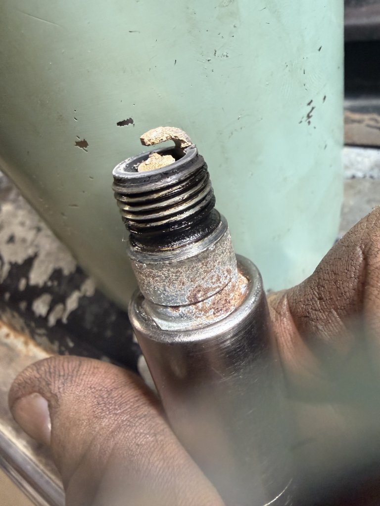

Cylinder 1
Compression test: 148

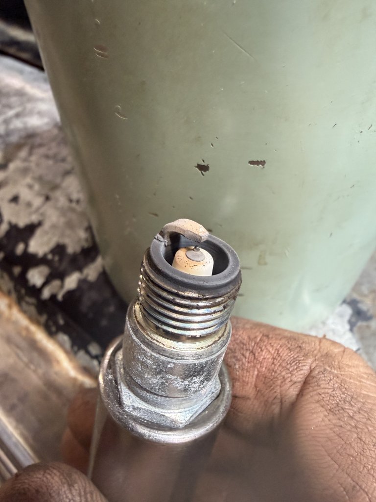

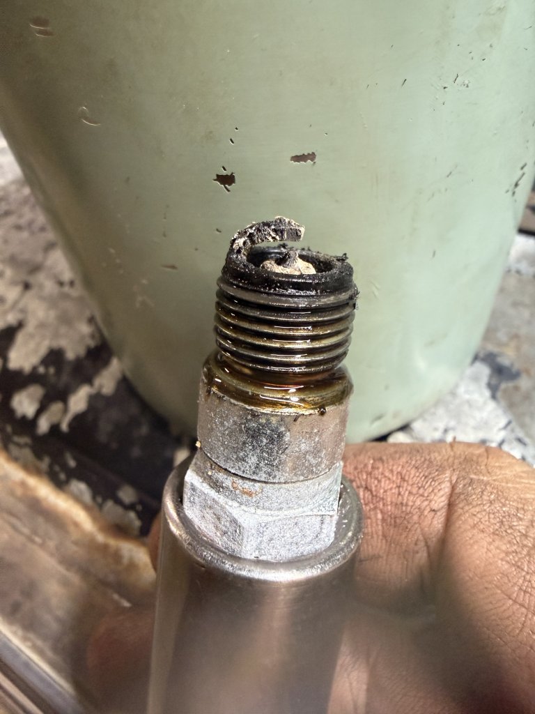

Cylinder 3
Compression test : 140

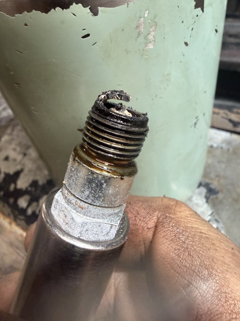

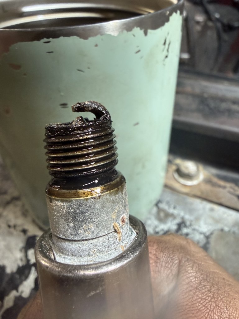

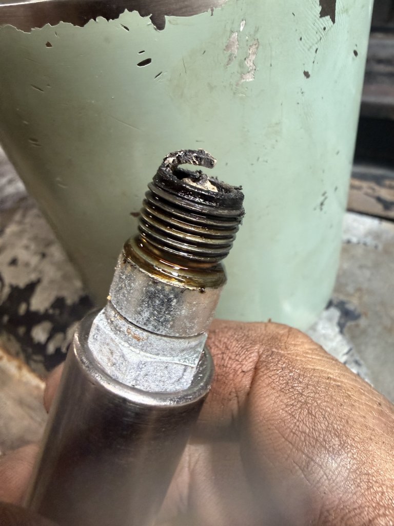

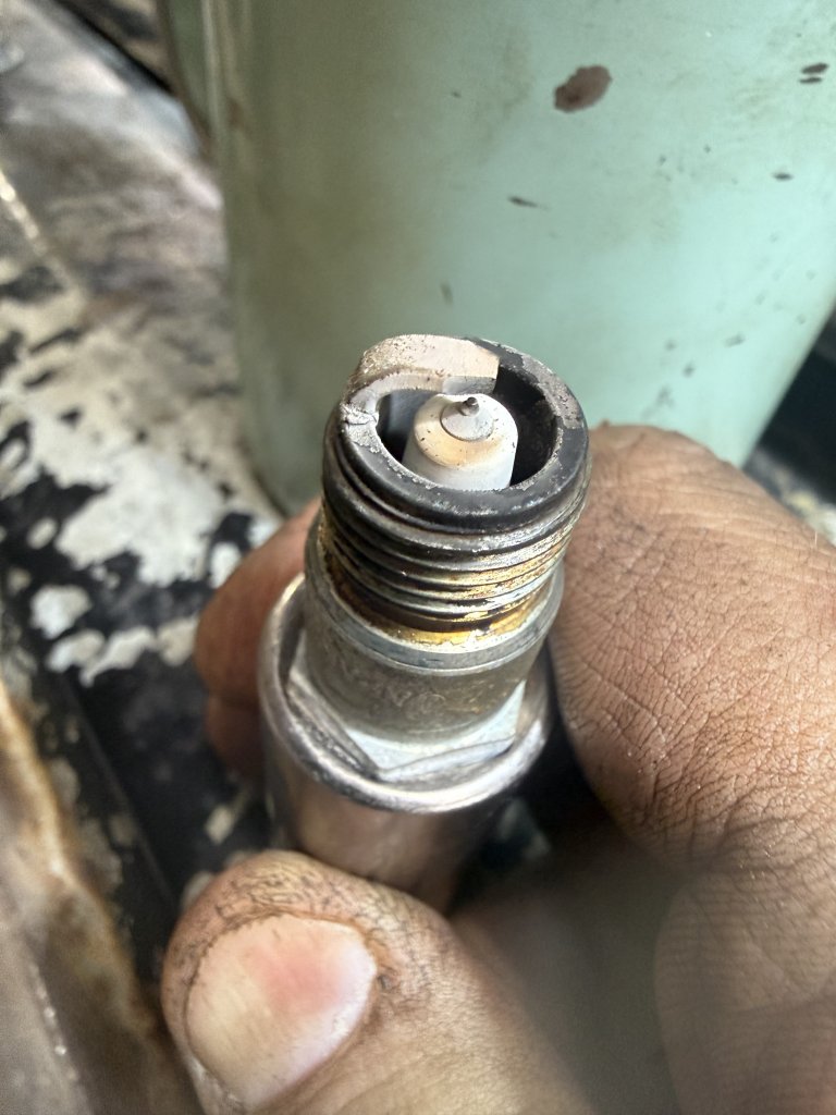

Cylinder 5

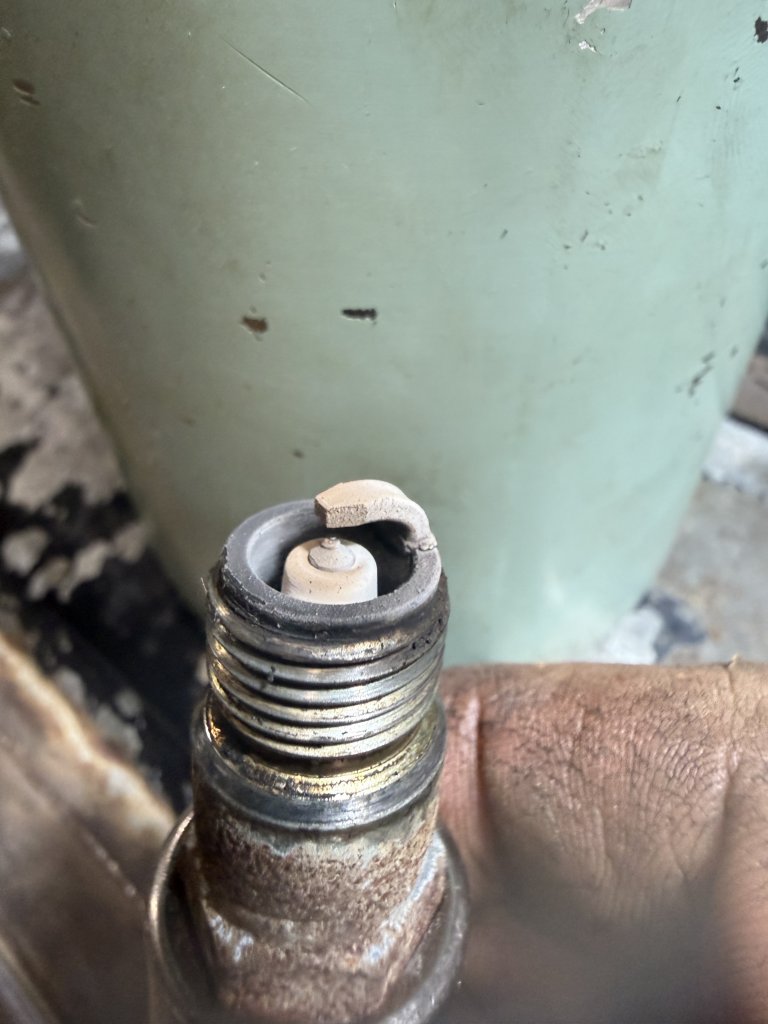

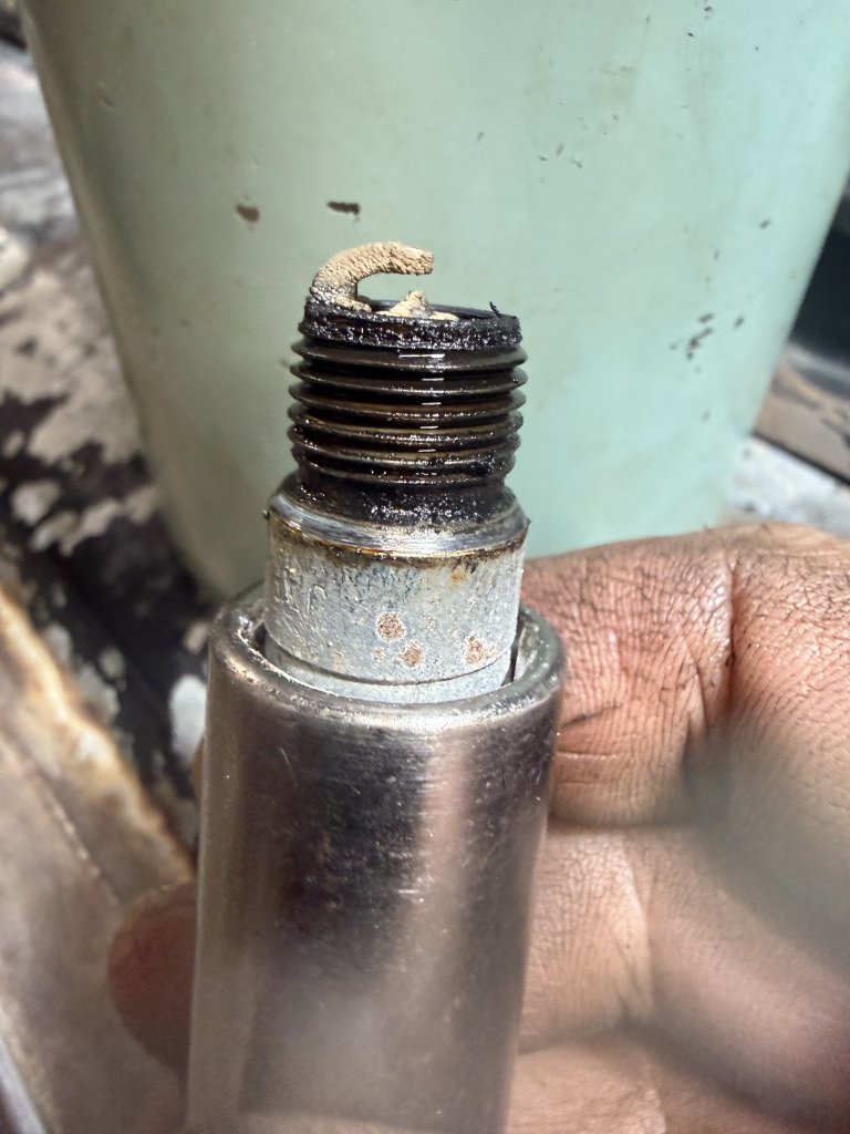

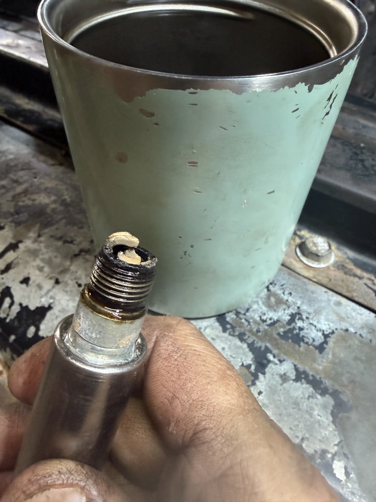

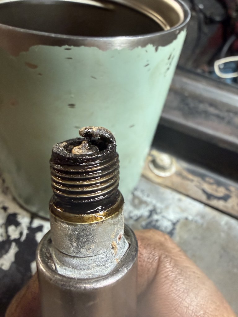

Cylinder 7
Compression test: 150
