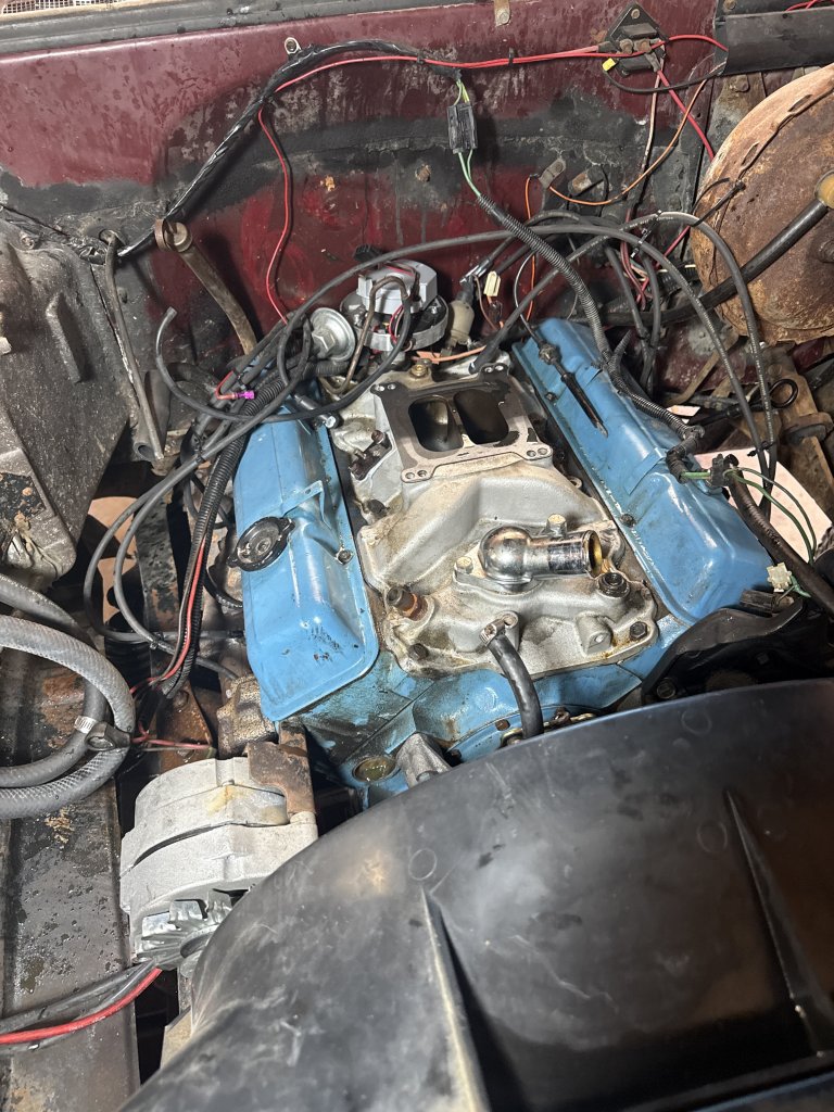

I figured out that my tuning problem was actually an intake leak problem.

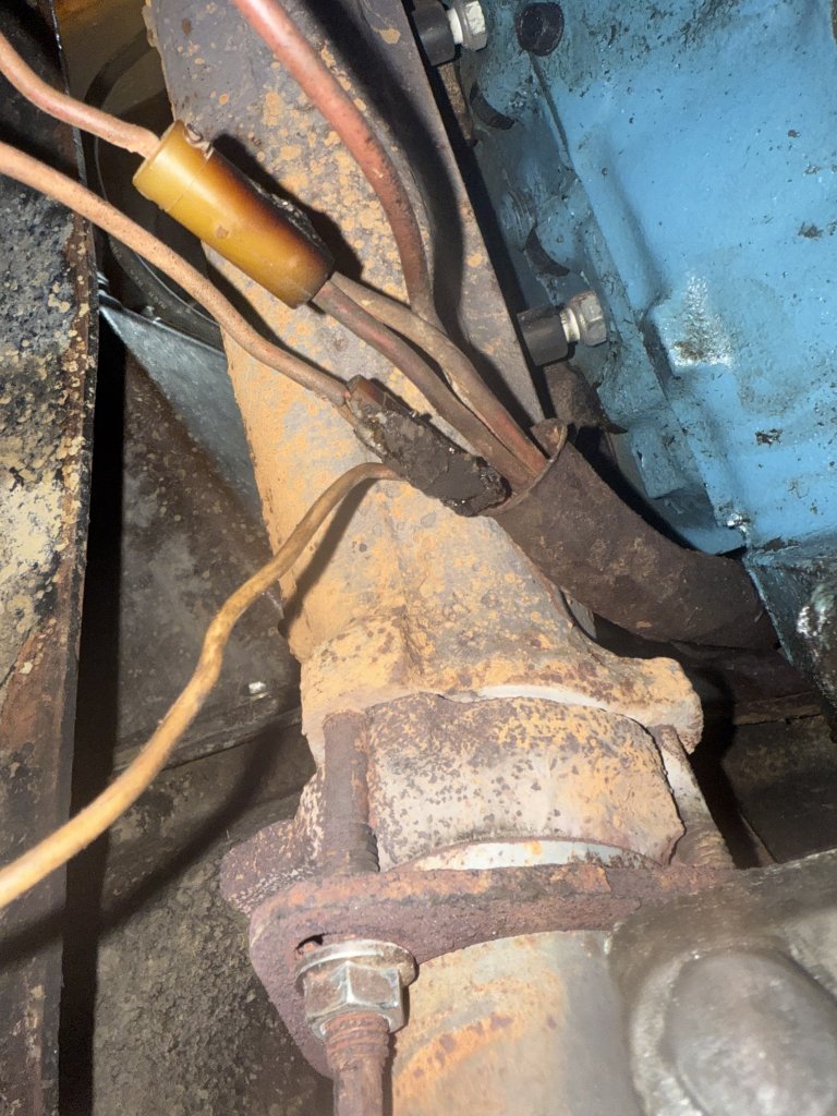

Finally got it started today. Thought that I killed my starter in the process. Seem like the starter is trying to spin too fast, made a whining.grinding sound, but still started the engine with no problem. Pulled the starter and noticed the wiring.
The wires going to the starter and to the fuel sending units are routed behind the block and into a tube that is bolted to the block. That tube, I assume is to protect the wires is normally bent towards the block, cleanly routing the wires toard the starter. In this cace it was bent away from it, as a result, the tube was making contact with the exhaust manifold, right before it connects to the down pipe. One of the wires (fuseable link) closest to that part of the tube melted and grounding out. I can only assume that this is the issue. I was working the starter pretty hard once I got it back together and figuring out the timing and such. I do have another starter that I might clean up and put on while im at it, just to be be on the safe side.
I've also replaced my power steering pump and lines. all three of the metal lines ends leak. They all seem to seat well when tightening them but the leak terribly under pressure. frustrating...

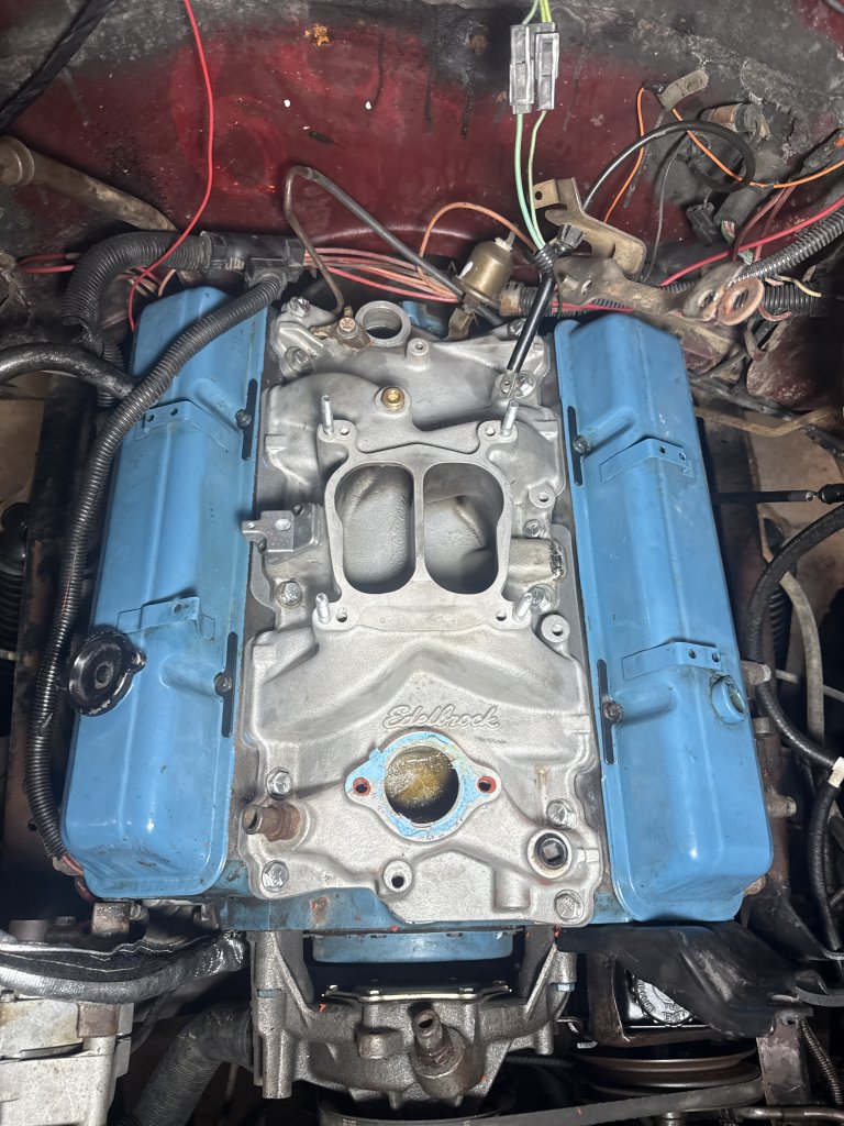

2nd new intake installed. First one failed immediately. Pretty sure I got it sorted now though. I got a thicker gasket to make up for the delta from the aftermarket intake and stock heads.
Installing drivers door hinges today while I’m waiting for the RTV to set.

How well did your bolt holes line up on both intakes?
