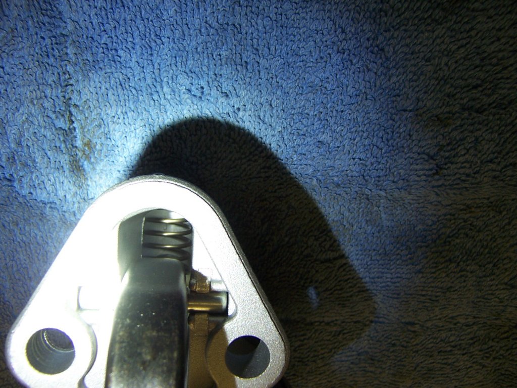

A couple years ago I put a new engine in an 85 K20350. The fuel pump appeared old so it was replaced. Afterwards, when trying to merge onto the freeway it started to run very lean, no power. Ran decent otherwise. After spending a bunch of time diagnosing a fuel flow problem, it ended up being the pump. The pump arm was partially stuck down and not getting full travel. Tried a replacement pump of the same brand. Same thing happened. No spring on top of either arm. Started looking at different brand pumps. Only brand that had the return spring then was GM. Now I have a spare, problem solved. Did another engine last month. That pump has different outlet angles. Searched and found a Delphi pump. It has the spring and I have another spare one. Just an FYI.
