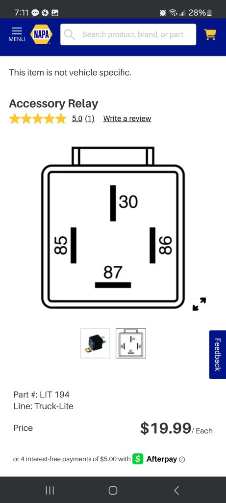

The best bet is run a hot wire from the battery to a common 4 prong relay. The relay you can get from any auto parts store under 10.00. It will have numbers on the bottom. 30,85,86,and 87. Run 30 to a fuse and to the battery. Hook 85 to the alternator exciter wire. I belive it is terminal 1 and brown. Hook 86 to a good ground. Run 87 as power to the fuel pump,this will get you a solid clean power supply to your pump. I will double check on the exciter wire color and position. But if you don't see an edit correcting it I listed it correctly to begin with 99.9 percent sure that's right,but it is from memory so I'll double check. Be sure your pump has a good ground also,wouldn't be a bad Idea to run a clean ground from battery to the pump as well.

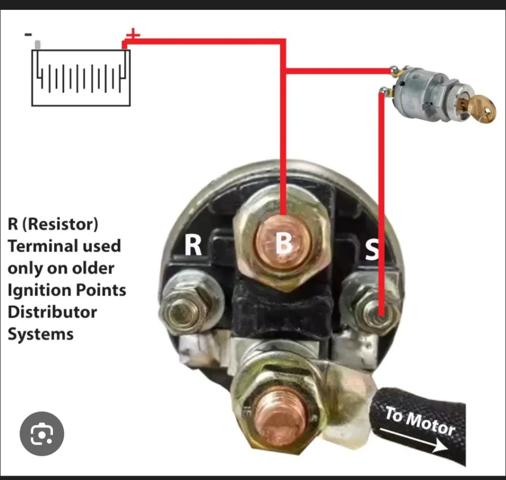

If you want.to add a prime circuit to the pump relay circuit in post 3. Add a wire from terminal r on your starter solenoid to terminal 87 on the relay which is also where your pump power is. When you crank, the starter solenoid will energize your pump for prime. You could put a momentary contact switch in the cab. Run 1 lead to 12V+ the other side to pump power at tge relay. When you push the button the pump will prime.

In their instructions step 4 use # 85 on the 10.00. relay.
Their #7 use number terminal 86 on the relay.
Their#8 use terminal 87 on the relay.
Their Circuit breaker is Battery or alternator positive to terminal 30 on the relay.

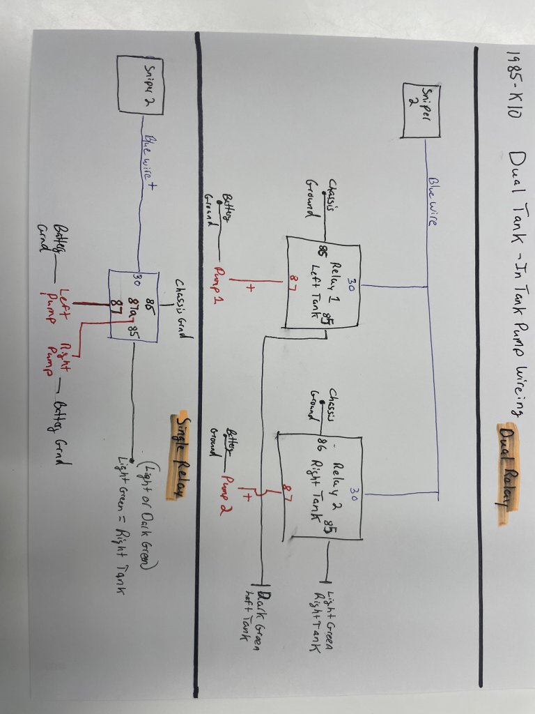

You definitely want the safety switch. This is a little more cost effective
Here is my pump wiring diagram using one or two relays.
