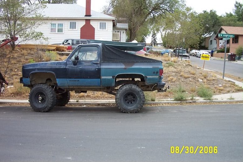

I had a set of dually hubs converted to single wheel.
cut the flange off turn down the hub and true up the wheel mounting surface drill out he threads for press in studs done worked great.
I think it narrowed the track width a little I am running 16.5 wheels no issues
had it in this blazer for about 2 years daily drove it and beat the snot out of it off road. with a arb air locker I only broke one stub axle no other problems.
building another truck with it now
