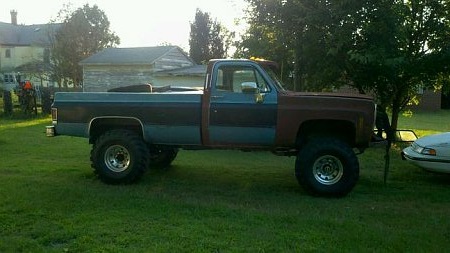

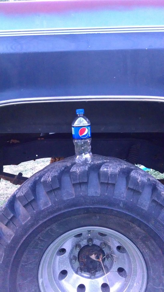

Show us a pic of the truck from the side.

Fixed

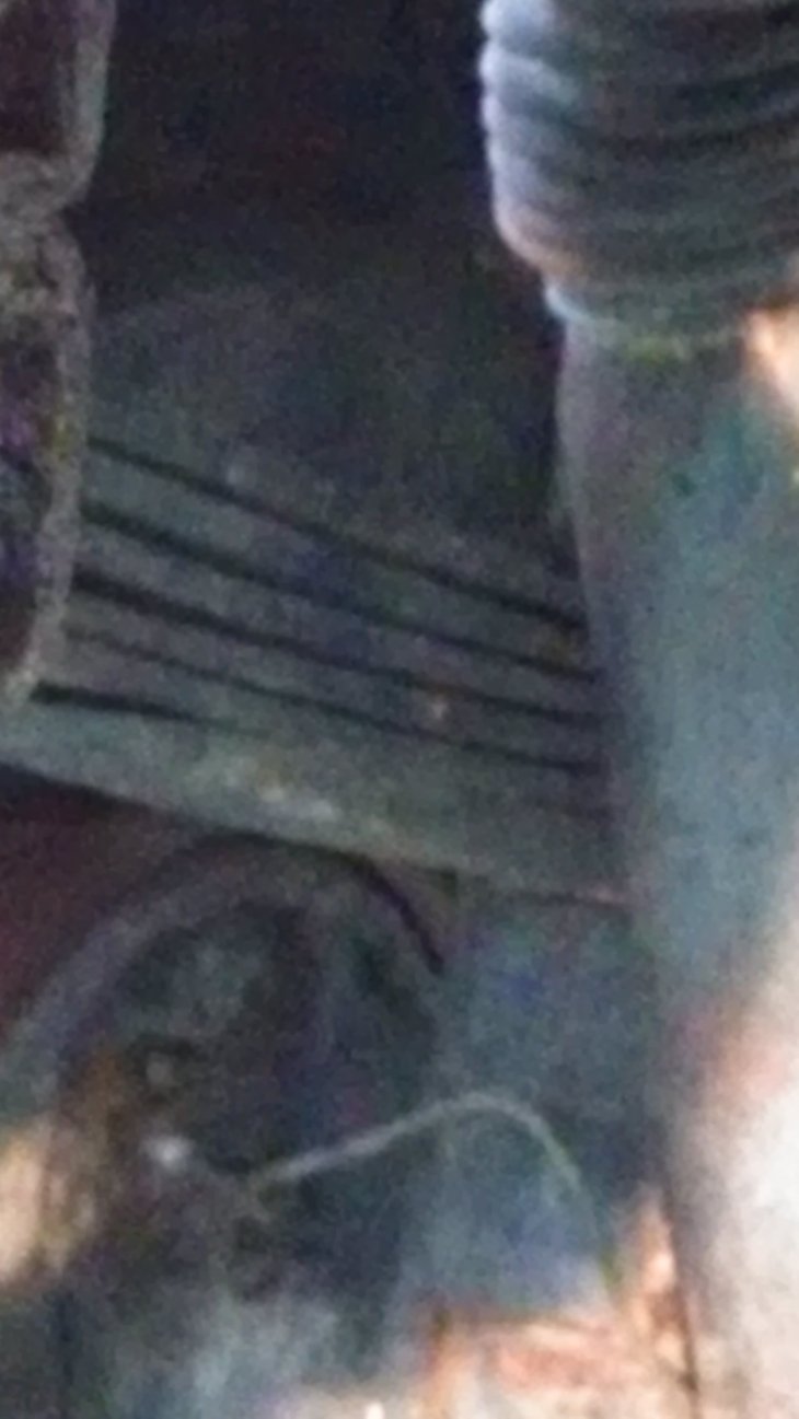

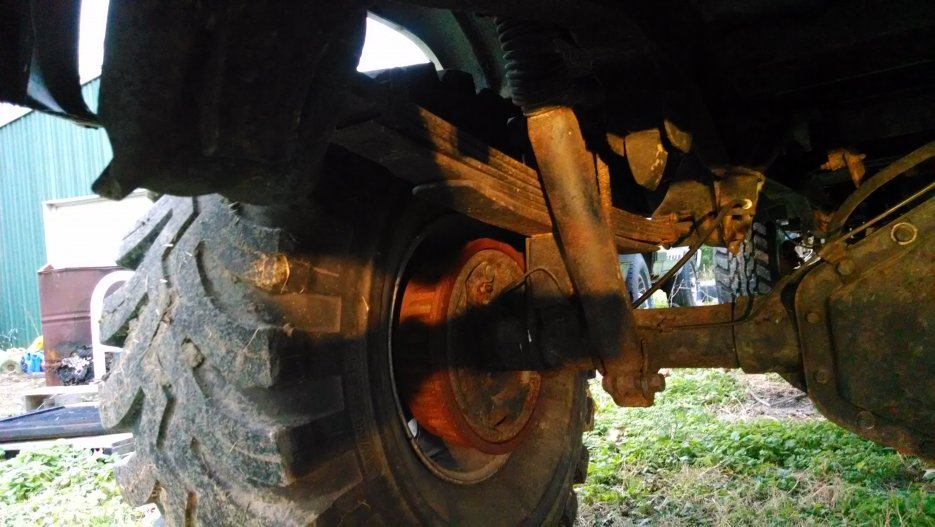

Here's what I could take this am.

Those are stock rear springs. So it most likely has a 4" suspension lift. Along withe the 3" body
