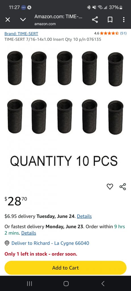

I believe timeserts are available in larger diameters for cases such as this?

Yep time sert big sert will fix it. Probably remove the helicoil maybe tap deeper install a regular time sert deep and judge depth maybe have to go studs and one deep stud. We also used to make inserts commonly on crap people have already buggered up.If it's too buggered for a time sert or a big sert. Pic a bolt big enough to fill the hole,tap the hole. Drill a pilot hole dead center of the bolt,then a bigger pilot hole. If you don't have access to a lathe,I know how to do it with a drill press,just ask. Lock tight your bolt and screw it in snug plus a little. Let your lock tight dry. Now you can hold the head of the bolt to drill and tap the bolt. Use a bigger bit to drill the head off and leave a chamfer.. Beauty of this method,you can go as big and as deep as you want. I'd stud it when I was done.

I like this idea. Going to do some reading on the time serts. Thank you!

I'd look at these inserts compare them to the helicoil. These are 1 inch deep and I believe the same thread as a standard helicoil. See what the threads look like,see how deep they are. If a shade over 1 inch and 3/4 good threads I think I'd use these inserts and make an instalation tool. If I question a fastener will hold torque on assembly I over torque it in advance,before assembly,if I can over torque it,I know I can pull factory torque. Thing about helicoils you can pull just a couple of coils. Timeserts are 1 piece.

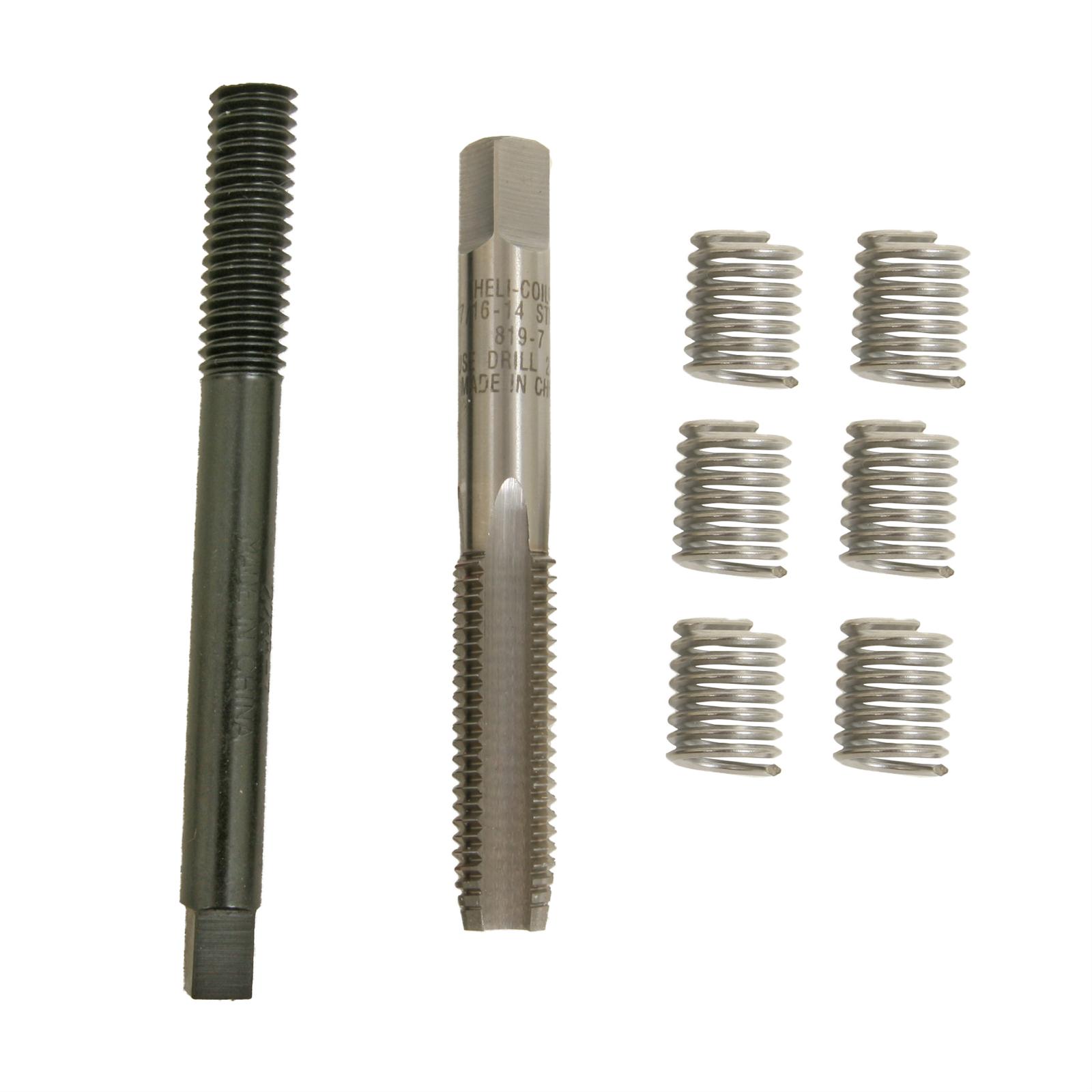

Just to confirm, these are the correct helicoils if I would start by trying to extract and reinstall one?

Lot of good info posted here by the members. Some common mistakes people make installing Heli-coils, coil is too long, your issue. The other issue, coil is set too deep in the re-thread, making the bottom of the insert too small for the bolt to clamp tight.
You can remove the insert by grabbing the top ring with pliers and just pull it straight out. The coil will stretch and come out. If it was installed with Loctite, warm it until you smell the Loctite.
