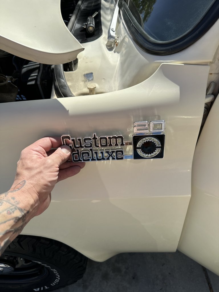

I did finally get the time to find my 77 fender and make a template. PM me your address and I'll get it in the mail today you. Here are a couple of pics for reference on placement. It follows the contour of the body. Hope this helps.
