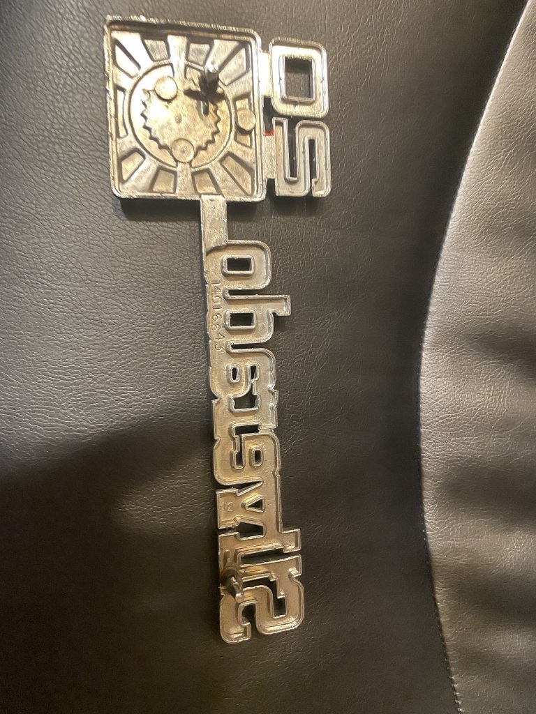

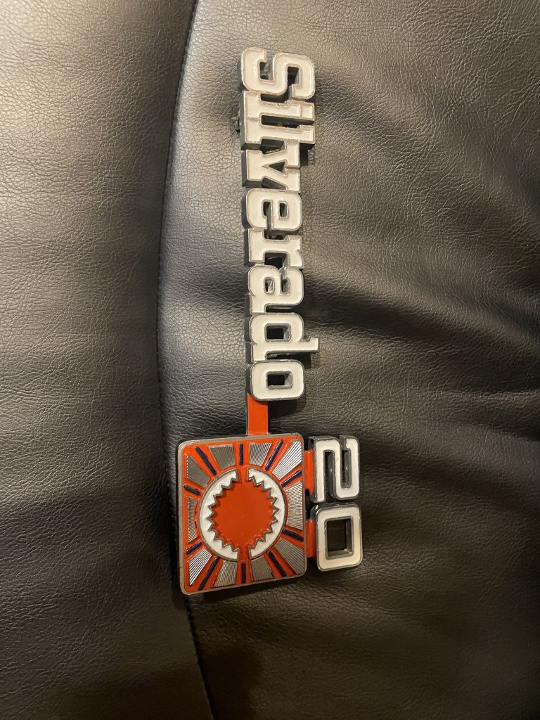

Those older style emblems have a lot of space between the letters which will require a lot of intricate tape surgery versus the newer style has none. They also are hollow behind the letters so not much surface area for adhesive tape. I’m planning to fill epoxy in a couple of areas of the letters so I can add a little bit of tape in addition to the two pegs. Tape will be more for protecting my orange peel paint.
Yessir. I am seeing the same issue with the tape on mine. There is a 3/16” gap on most areas

So, I’ve had ol Goldilocks for eight years. 1977 C20 Custom Deluxe. She is basically “debadged”. Not my doing, but I’ve always thought she’d look sexy with a pair of fresh original repro fender emblems.
Enter my mental anguish. I bought a pair knowing in advance the conundrum. They are sexy tho… The badges come with a pair of 3/16” diameter unthreaded mounting pegs. My truck doesn’t have mounting holes for the badges.
Here is my issue: does anyone know of a template or otherwise possess the measurements for proper mounting locations? The back of the emblem has a radius to it, so it matters what height you mount the emblems so that it sits flush. I would also have to pick up some barrel nuts because I don’t want to pull the fender off to screw the nuts on. Plus, do I really want to drill holes in my damn fenders??
Enter Plan B. I could use many layers of scotch extreme mounting double stick tape. It actually works pretty good but I would be fairly upset if it failed and I got to watch my $60 emblems go bouncing down the highway to their death. I could also use that black mounting goo, but if I apply it wrong on the back of the emblem and it squishes out, it’s kind of a hard to reverse eff up.
I have an obviously bad habit of overthinking the hell out of these types of problems, but I know there is wisdom to be found in these forums and so I call upon my fellow problem solvers. At the moment, I am leaning heavily towards the scotch double-stick tape. What does everybody think?
