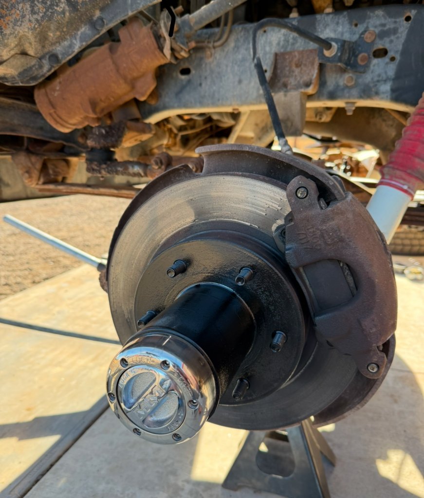

Did some troubleshooting and the front driveshaft turns if you turn front wheels when front end is off the ground. Removed a hub and don’t see anything broken but guess I’ll order hubs and hope that fixes it.
Also tried to adjust TV cable for 700R4 but it’s not self adjusting like it should. It wouldn’t downshift when stomping on it after adjustment so I set it back to almost where it was. Super tight at wide open throttle. It was limiting full throttle before.
