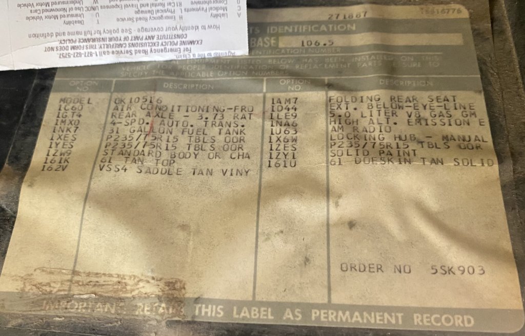

I just picked up a new to me 1986 K5 blazer. Glovebox build sheet says it has the LE9 5.0 Liter V8 Gas GM. It supposedly has 190k on it and runs really well except for some blue smoke unitl it warms up. I have the 700R4 4 speed auto and thankfully GT4 rear axle 3.73 and NP 208 transfer case.

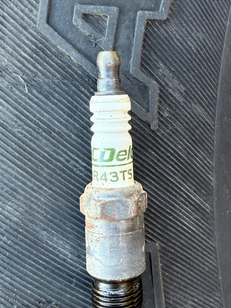

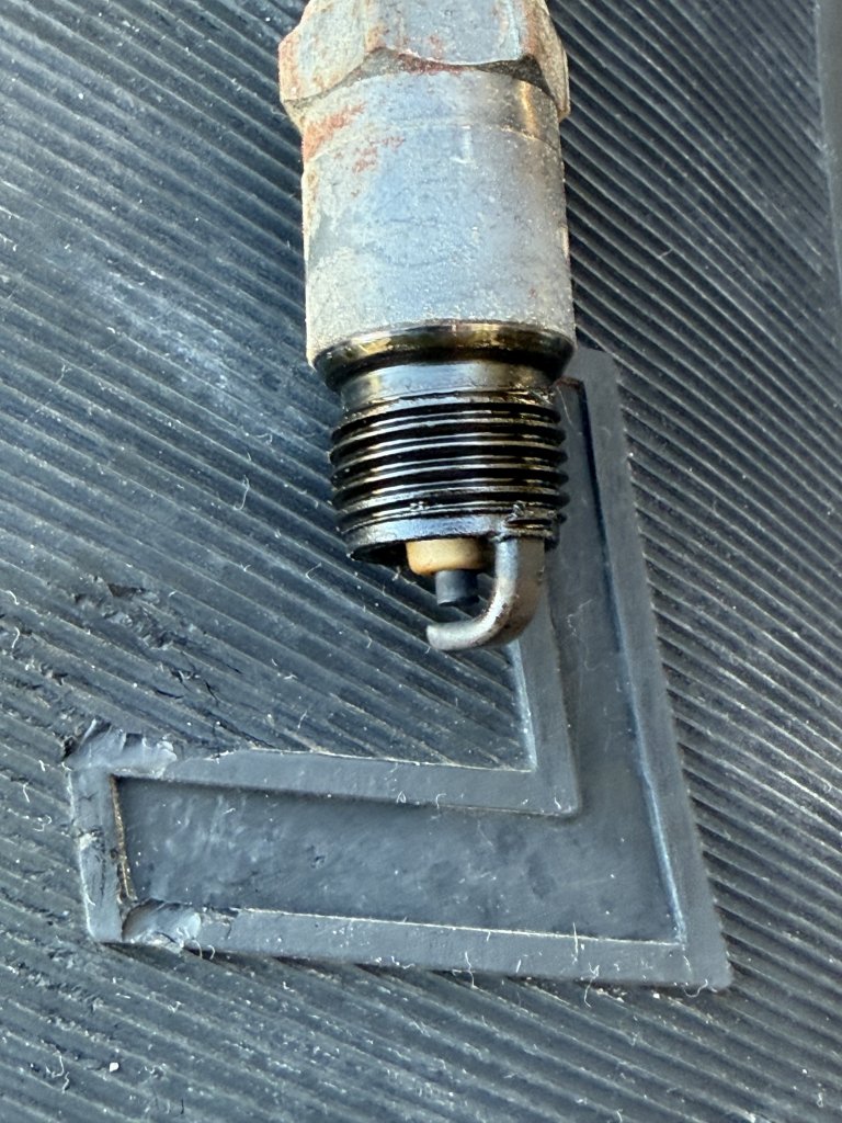

The spark plugs in it look good so just going to leave those alone.
