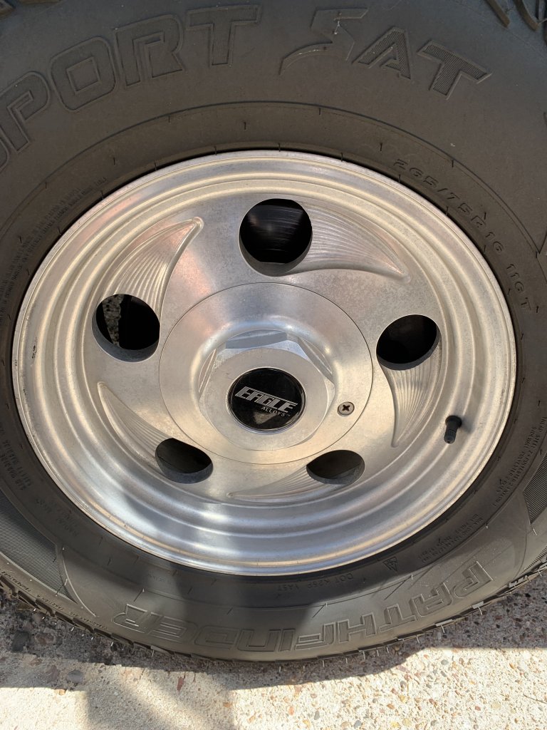

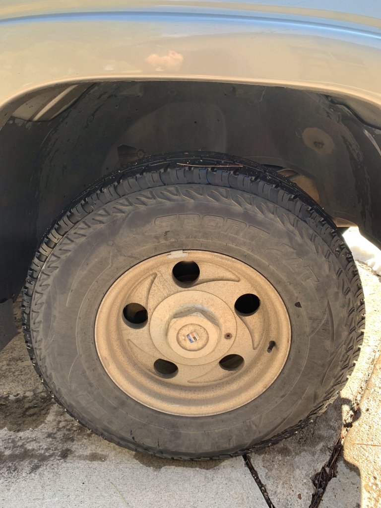

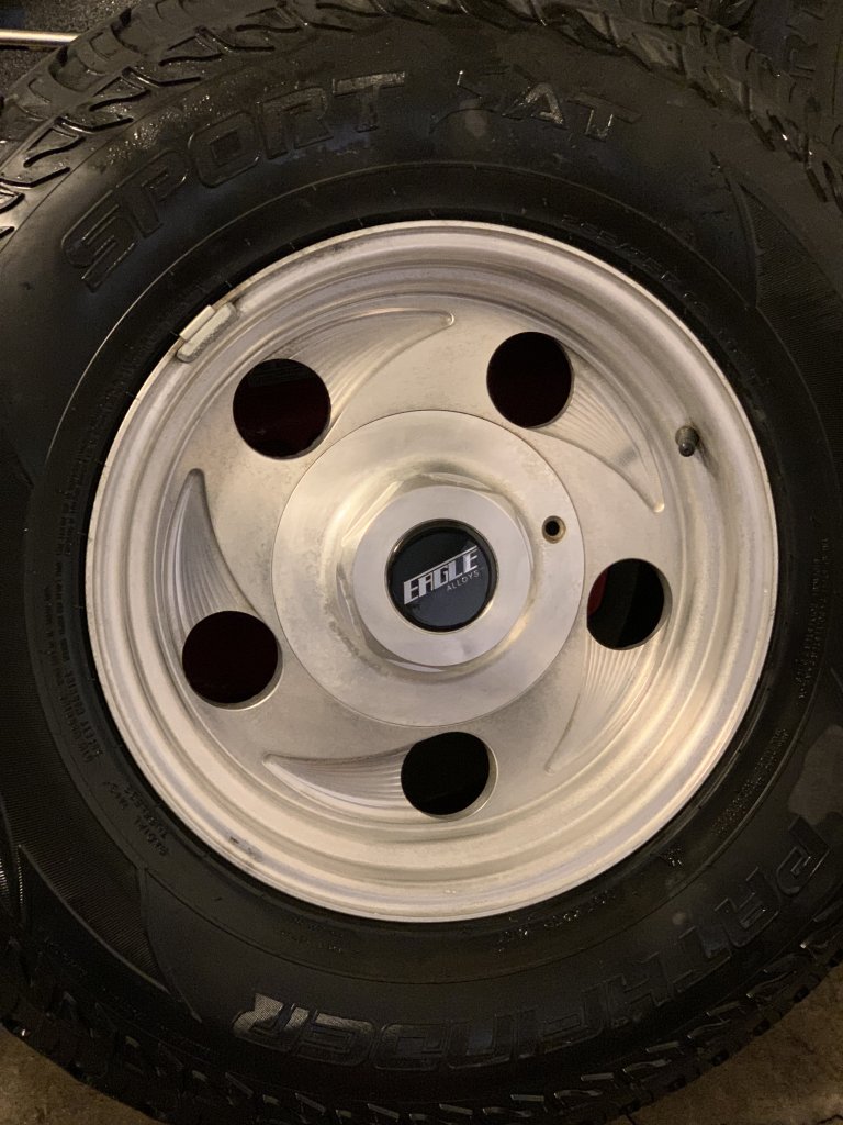

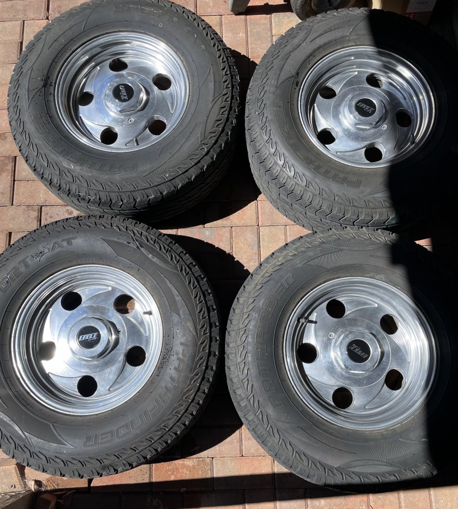

I actually used the oven cleaner to restore some eagle alloy wheels that were terribly neglected for 10+ years. It worked great to get all the corrosion off along with steel wool. Then polished with mothers and they still had a great shine. Oven cleaner certainly dulled the aluminum but they were so pitted and corroded I needed something to eat through all that crap. I did notice the aluminum / tin trim around my brake lights got striped but those were ultra cheap eBay special tail lights.

I used my orbital buffer with wool pad on the gel coat after the 205 polish. It certainly helped give it some gloss.
After
Before
Happy I don’t have to see the old white spray paint streak off down the side of the truck every time it rained or morning dew.
