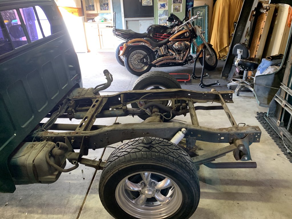

I've taken the over ride rear leaf and 1 more leaf out of the rear suspension. I have attached an old pic of the rear before I took out the leafs. Do I go drop shackle with it?

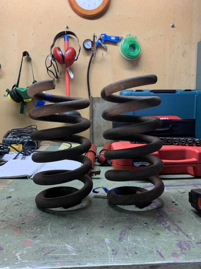

These were the front springs that the previous owner "Butchered" couldn't even cut them the samer length :(
