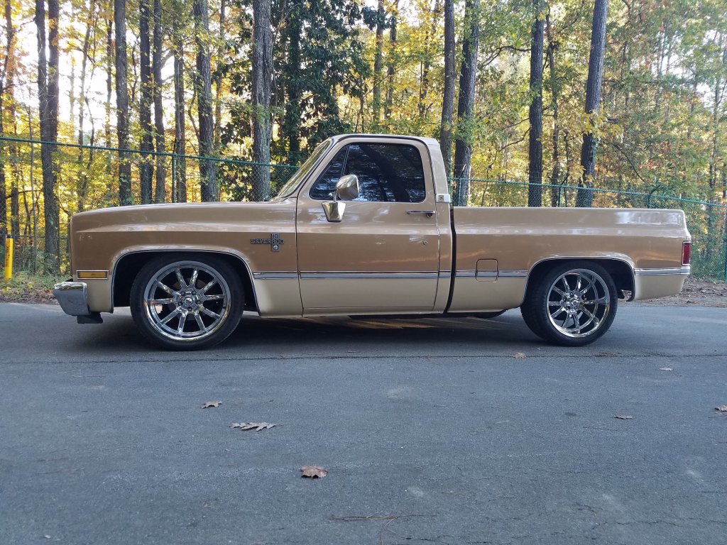

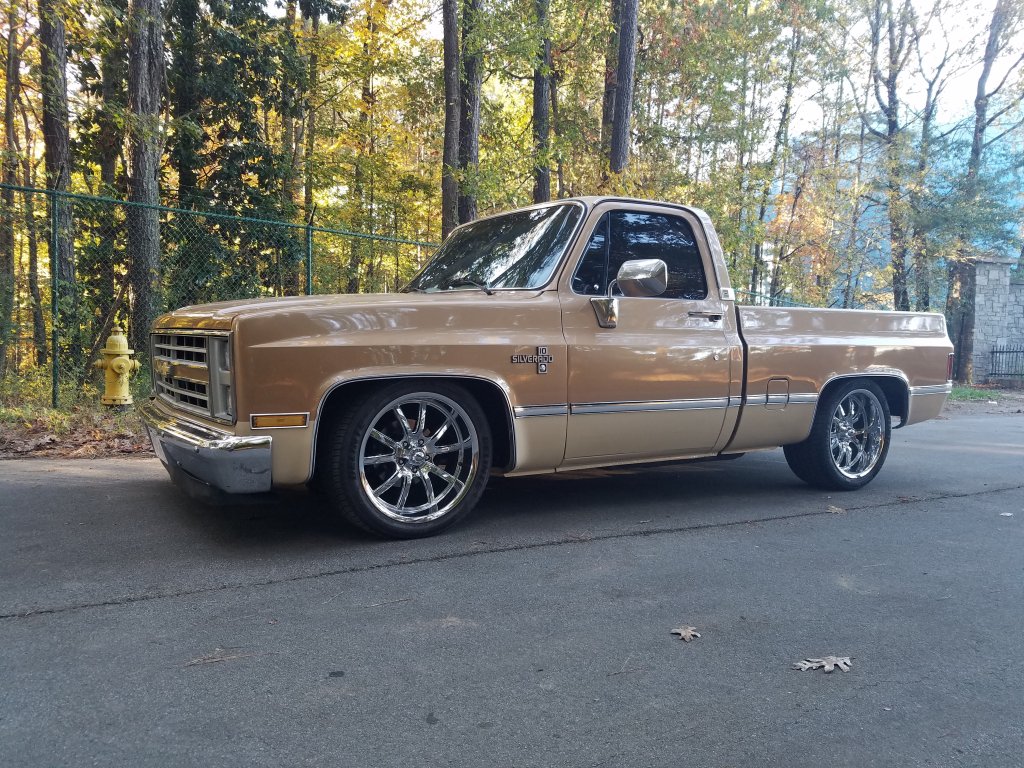

Well, I finished up getting the rear shock extenders on and was able to go drive. I rub in certain situations but it's not too bad. I will be altering my bump stops in the front to gain more travel before hitting them. I think I'll try trimming the stop first. This may cause the rubbing to be worse. We'll see what the future holds. Overall, I'm happy with everything on the front end. I may drop the rear another 1/2" with a block. I'm at a hair under 27" in the front and right at 28" in the rear for the wheel well openings.

Looks pretty sharp, but personally I feel like ANY rubbing at all in any situation would be completely unacceptable. Your vehicle is having trouble getting down the street normally because of the modifications. I understand form over function, but once the styling makes the thing less derivable in everyday scenarios, that's a sign to me that there is a problem that needs to be fixed. Don't forget, this is not a Corvette here it is a 35 year old pickup truck we're talking about, there's a limit to what it can do regardless of how bad you want it to be a certain way it was never designed to be...
Also, why is it a problem that the rear is slightly higher than the front? We're talking half an inch here. I bet if someone put a new roof on your house and one side was half an inch lower you wouldn't notice or care, yet a truck that has suspension that moves and changes as you drive even whether or not you park on level gorund, now a half inch is this huge deal? What a minute measurement, these trucks were so poorly built from the factory some of them have more than a half inch ride height difference just to begin with. Everyone with a lowered truck seems to want it dragging a$$, IMO having the rear up just a tad gives it more of an aggressive stance, like a race car is always slightly up in the rear. There is something unnatural about a vehicle that is dead level or even lower in the rear. As soon as you get on the gas it should straighten out (especially with the missing leafs, I bet under even light throttle it's all nose in the air looking), unless you plan to just sit there and look at it parked all the time...
You got a good truck there, just be happy with it. You can try to chisel it into a work of art but it will likely never be good enough, will probably cause more headache down the road, and realistically most people will not even notice one way or the other so save yourself some grief and just enjoy what you got.

I understand what you're saying, Kevin, and you're right to a large extent. The truck is a toy for me and spending time tweaking it isn't a chore, it's my hobby. So while most people won't notice the extra 1/2", I will because I stared at it long enough to know what I want it to look like. It will still have a slight rake even being 1/2" lower in the rear.
As for the rubbing, it's only when turning tightly so far. If it gets worse with my driving and more situations that I come across, I'll get Slosh Tubz. I figured I would have to get them eventually anyway. The fact I can drive the truck now without them is a bonus really.

That's cool man, I really wasn't trying to sh!t on you, your truck, or your taste. Do whatever it is that makes you feel good, I'd just hate to see you stressing over something that really doesn't matter that much in the scheme of things. But if tweaking it into perfection makes you happy then who am I to say not to? You got a good truck there, I hope you can at least appreciate that much. If you want to keep working at it then that's up to you, but don't for a second get down about the way it looks. Anyone who sees that truck and knows f,uck all about cars will realize that you've put a ton of effort into it, just realize it's good the way it is and anything beyond that is just your hobby at play.
