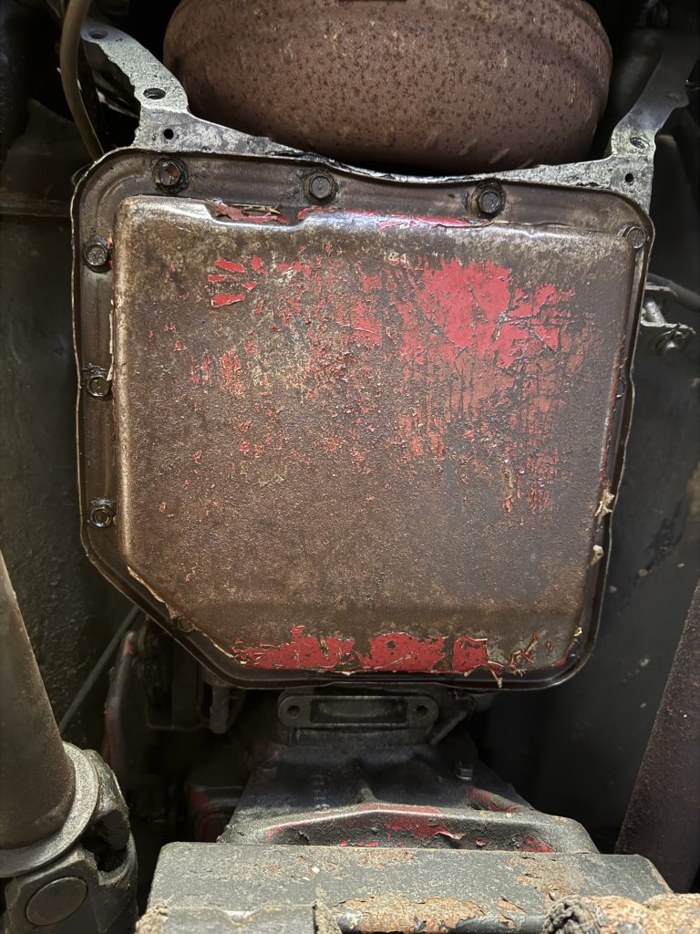

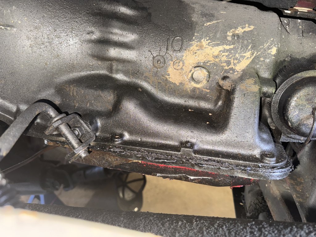

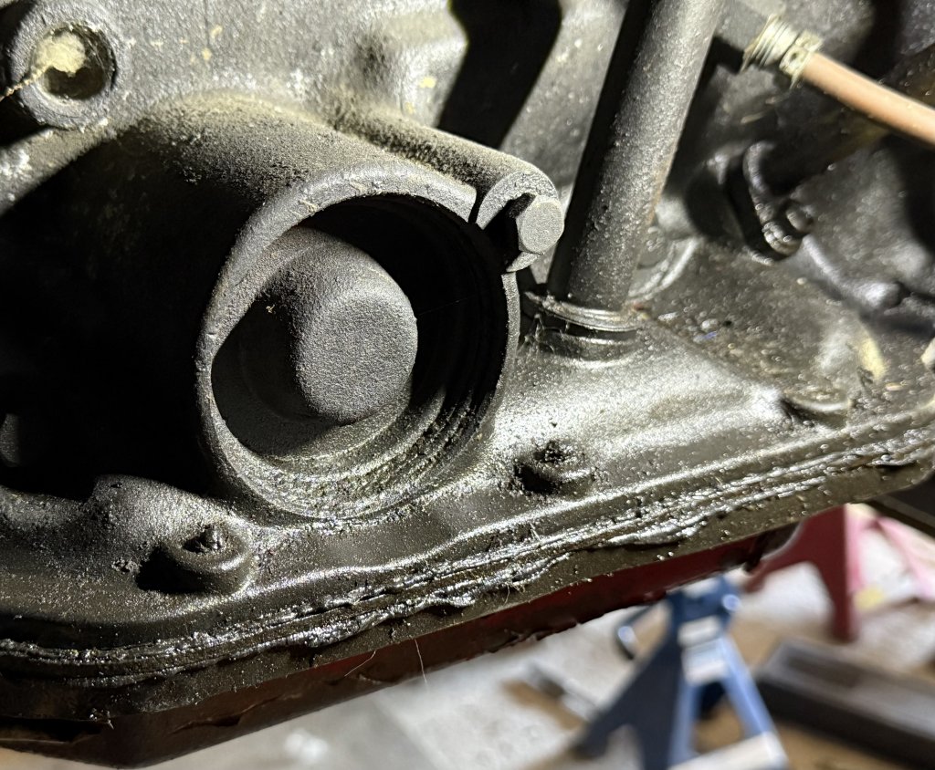

Is this a TH350 & which flex plate???
Jordi
Mar 2, 2024
113
279
united kingdom
Daniel
6.2
I cannot find a serial number anywhere the manual says, most likely its all just too grimey and i’ve not cleaned it well enough.
One website says you can go off oil pan shape & bolt pattern which suggests its a TH350.
Before i order bits if anyone could confirm.
Thanks.

That gm oil pan chart is the chit. Yes.
hey mister
Jun 15, 2024
519
1,164
North Coast
Marty
Yep, 350.
TransGo makes a fantastic shift kit for under $100.
On a scale of 0-10 with 10 being very difficult, I would say it's a 4 or 5.

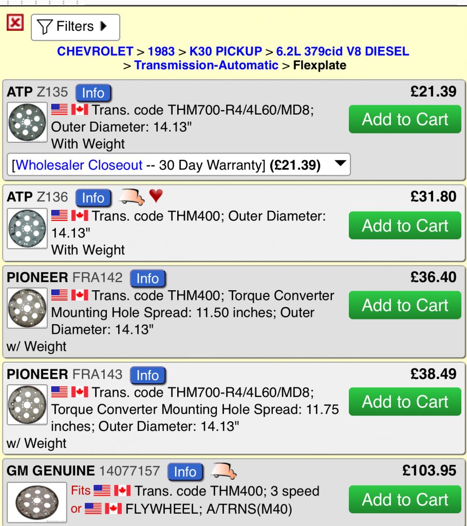

Next question then, is the 139 tooth flex plate the correct one?
It is a 6.2 diesel.
