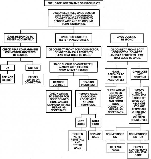

A special tester is required to diagnose this type gauge. Follow instructions included with the tester.
Gauge failures are often caused by defective wiring or grounds. The first step in locating trouble should be a thorough inspection of all wiring, terminals and printed circuits. If wiring is secured by clamps, check to see whether the insulation has been severed, thereby grounding the wire. In the case of a fuel gauge installation, rust may cause failure by corrosion at the ground connection of the tank unit.

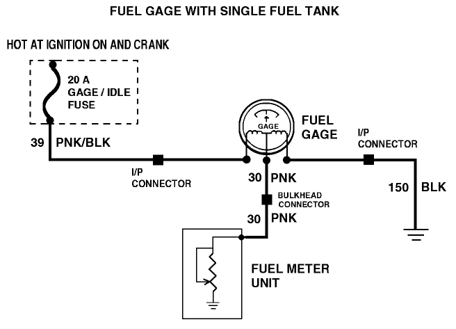

Basic schematic. Note: this is applicable to all dash indicators (i.e. gas tank level, coolant temp, oil pressure):
