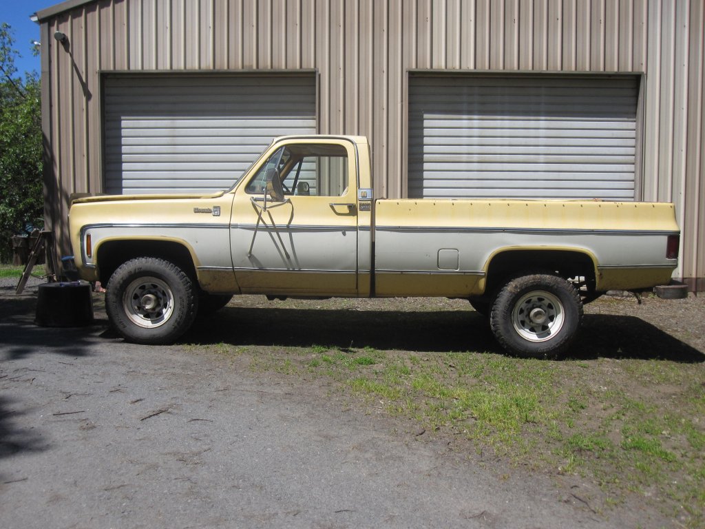

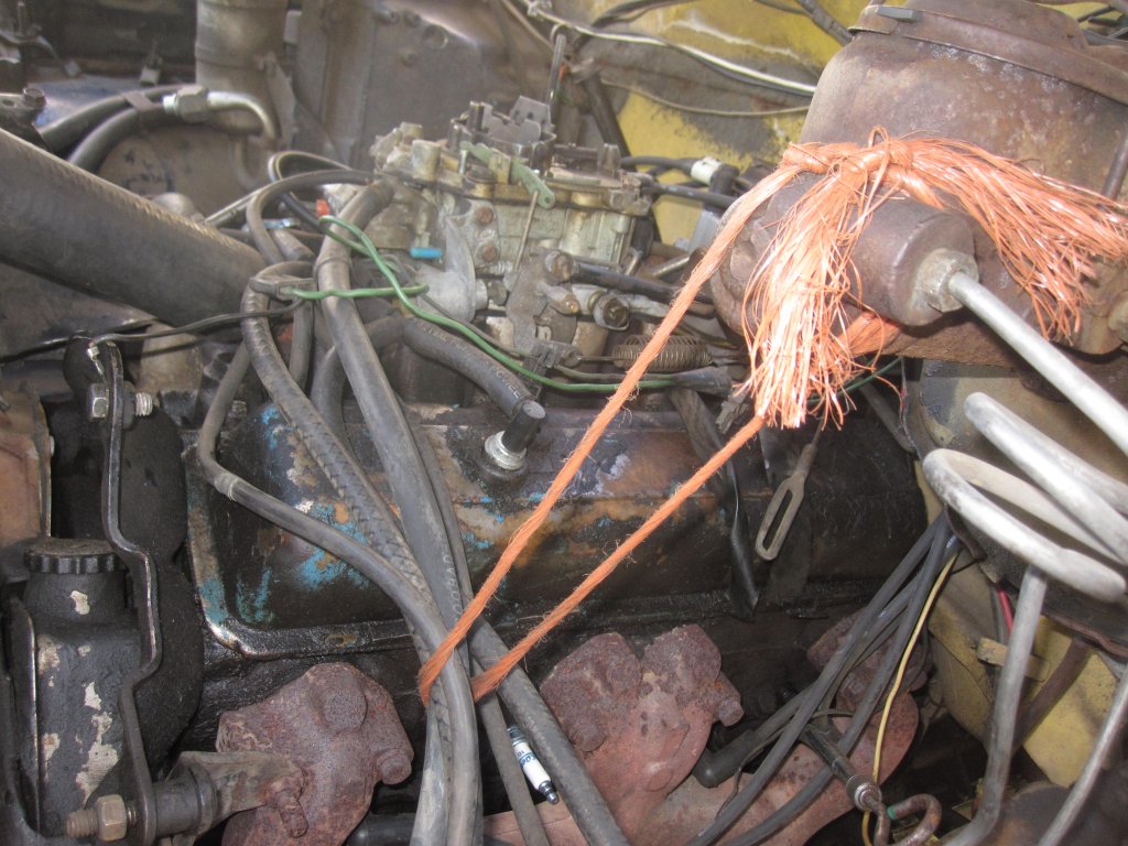

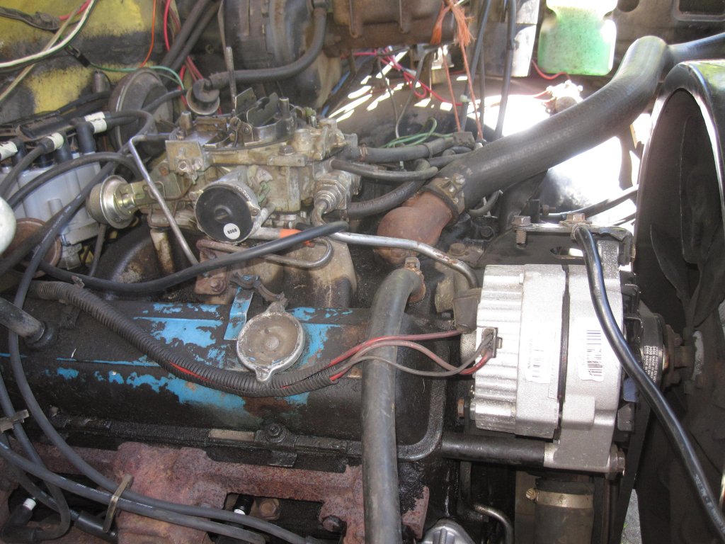

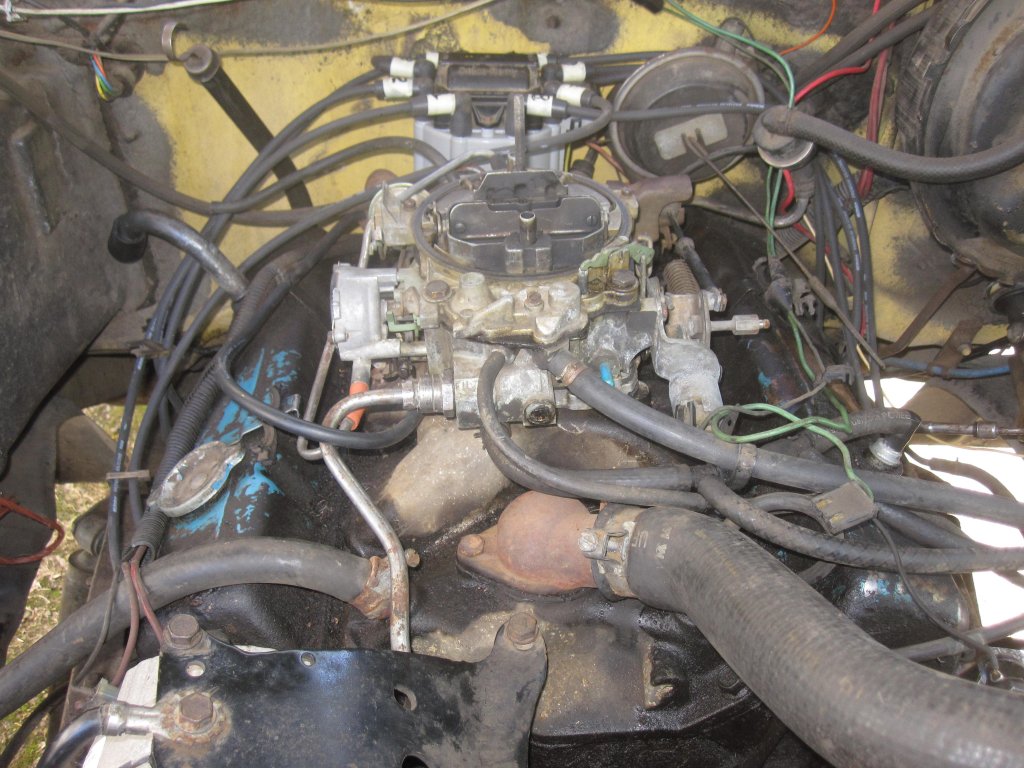

Show us some pictures of your K20 and the 400, please. We can probably "practically fix it" (everything but the work) with a little more info. Then you can go to your mechanic and tell them what you want done and why.
yellowdog5
Nov 3, 2019
85
37
Faith
k20
I had the carb gone through twice a couple of years ago, the second guy I thought knew what he was doing, the truck was running fine and starts right up warm but took 80 pumps (no exaggeration) or hand priming to start it cold. This guy wants to replace the carburetor to intake manifold gasket and what I think I learned from you guys are just ordinary manifold gaskets. There are other problems with the truck now too, but he wanted to start there, he found some air leaks around the gaskets.
I can probaly replace those myself with a little coaching, but I really don't know if the carb needs work also. I would like to address the other problems as well, I can live with priming it to start temporarily. I have changed all ignition parts: plugs and wires, coil cap rotor and icm. Also changed the fuel pump. It runs really rough and weak until it gets up to about 45mph then smooths out. None of the stuff I did helped much, fuel pump maybe alittle. It did need a tuneup.

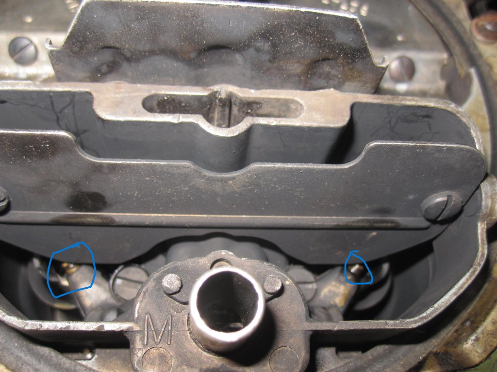

Cold starting would be more about the choke adjustment and pump shot. If it starts with a primer of gas down the carburetor, that would indicate that it is not getting enough gas. I am thinking it is the accelerator pump plunger, or nozzle is clogged up. That would explain the slow acceleration, without the squirt of gas when you step on accelerator. Can you look down thie top of the carburetor and see if there is a nice strong pump shot of gas coming out of both sides of the squirter nozzle when you work the accelerator?

I tried it both with the engine running and not running, as far as I can see there is none coming out of the nozzles, when I work the accelerator. Picture to see if I was looking in the right place, I'm not very up on carburetors. Also not good at drawing with the computer ;)

That is the problem. Your accelerator pump is not working. The plunger is probably torn or hard or something. The top needs to come off of the carburetor to put a new accelerator pump plunger in it. While it is off and open, it can be cleaned out and sprayed out with carb cleaner. You will possibly need a new gasket between the top and main body. You may be able to buy these parts without buying the whole carburetor kit, but it may be faster and a better value to just buy the kit.
