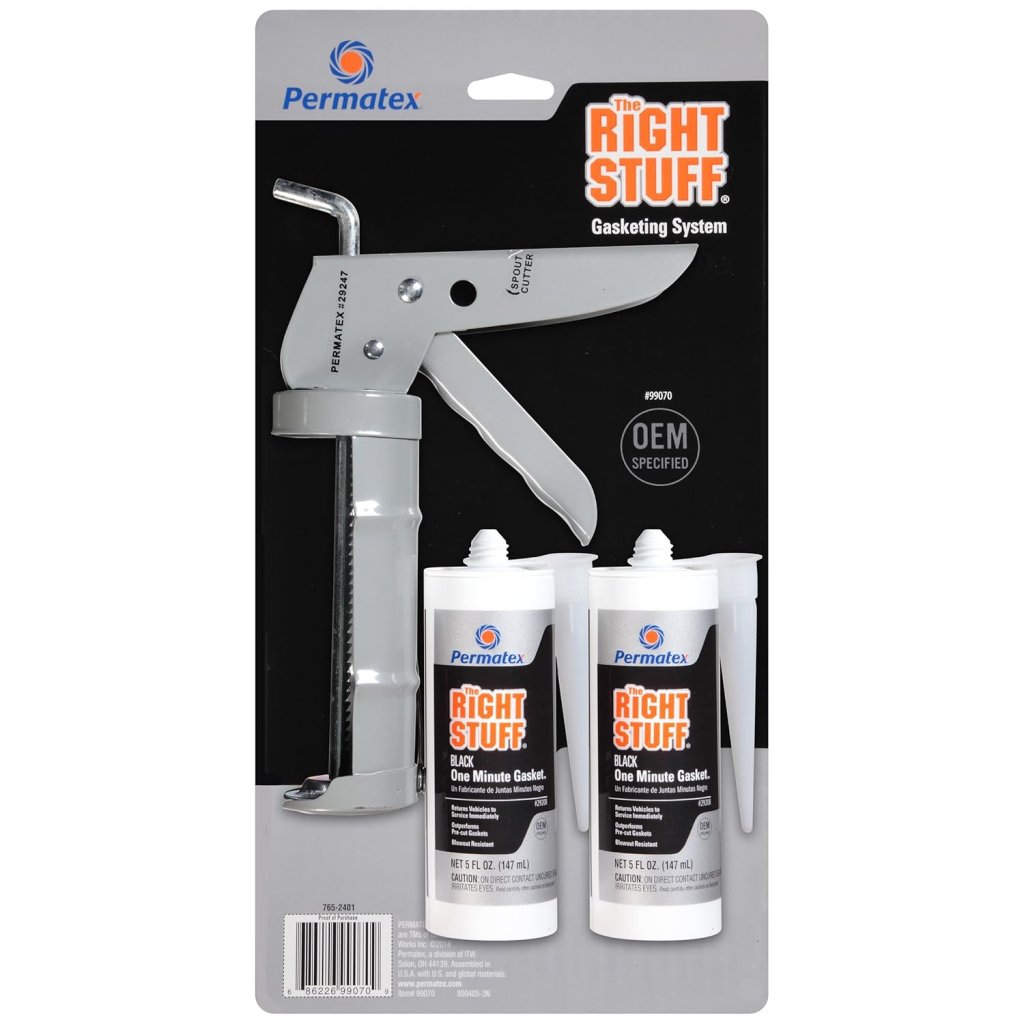

Not sure if this would work, but what about no gasket and a nice thick layer of this:
