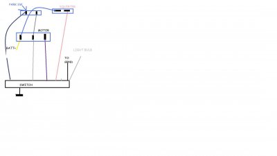

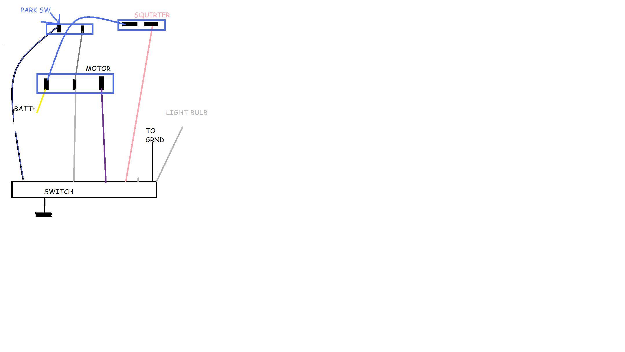

It's hard to follow the wires as shown - but anyway;
Try running a jumper from the steel wiper motor casing to the negative on your battery. did that, no change.
Also, and I really have no idea on this, does that motor/module/switch (switch is just not shown I guess) does that group all belong together? I mean are they all from the same year? If so what year?
switch/module are a pair, motor is from an 82. which is the same as the truck that this switch/module works in. 78-84 use the same motor.
And last but not least - I am so red/green color deficient that the color of those wires ... well I can't be sure of any of them, other than the blue and black. ill fix that.
But bottom line - you can take those exact components to a 1980 truck and the system pulses it's ass off - right? yup. perfectly
BTW how many wires feed into the module on the side we can't see?
9, 6 on one plug and 3 on the other
here hope this helps

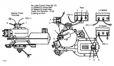

These dwgs are from the 1983 manual (I hope they are wired the same):
If you wire the circuit just like the dwgs show, and it still doesn't work on pulse...IDK, maybe intermitent wipers are just not in your future.

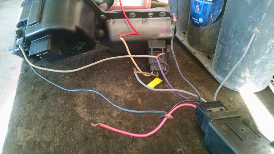

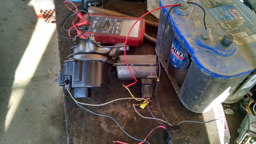

looks like i got it right.
only thing it that diagram with the motor does not show a park switch.
but i have it wired
gray to low spd wire on motor
black/lt blue to black/lt blue on switch.
somehow i think its in the parking switch wiring that is not letting things work. but i cannot figure it out. it parks properly. but doesnt pulse. it worked in an 83, and an 81. but this 77 is the child of satan. and it will not work. as far as i can tell.
so with that info, if no one can figure out the error. I am sorry but i give up. I have wired nascar series race cars from scratch for a living for 3 years i have built electrically controlled oil heaters that can maintain a certain temp and auto shut on/off at varying temps. I have eliminated wiring to swap ls motors into rat rods and sand rails. And I currently own an auto repair shop. I am well versed in wiring and diagrams/schematics. And this little 6 wire setup has me completely stumped. I even had a friend that does computer and electronic repair for plants for a living. He came to the same conclusion I did. Completely baffled. I have been defeated by a simple wiper system. there must be something in the wiring of the trucks starting in 79 that I cannot find or figure out. And no amount of bench testing has created any results that were satisfying. even trying to mix and match 4 different switch/module combo's. I was hoping I could make and end all, be all thread for doing these swaps but apparently, thats not to be. I forfeit. Theres enough diagrams/schematics and homemade photos in this thread to choke a horse. maybe someone in the future will see something.
