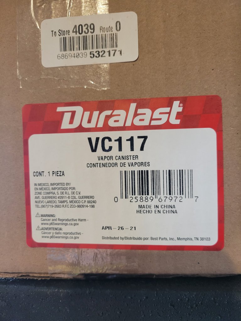

When we went through the vacuum system on my son's truck, we found his replacement at Autozone. It looks very much like the original and fits and works properly. And yes, it was about $100.00 When you take into condsideration that they last for 30 to 50 years, and usually only have issues when something else goes bad and fills them with gas, seems pretty reasonable. I have mine connected on our classic car so I can park it in the garage and not have the garage smell like someone left an open gas can in the garage.
