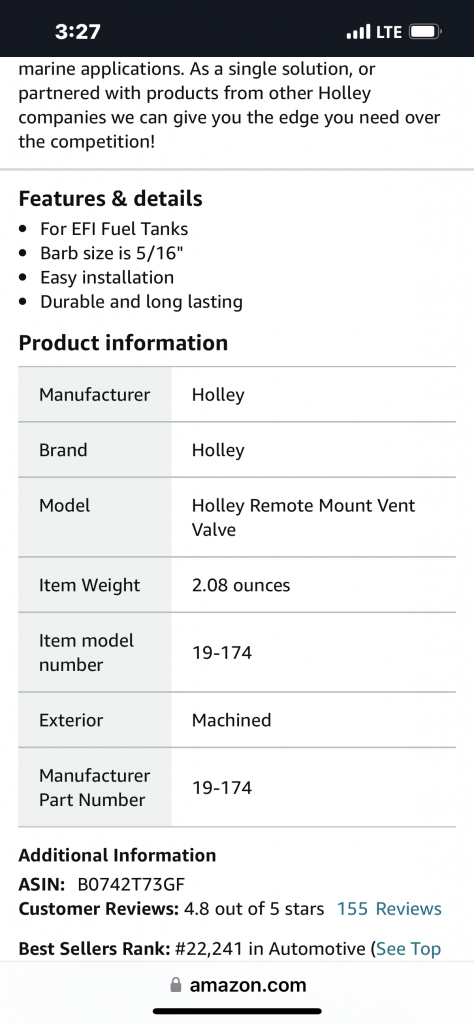

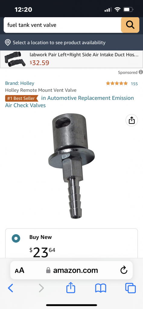

What do y’all think about using this vent as suggested above?

squaredeal91
Mar 10, 2023
2,757
5,109
Cave junction Oregon
Greg bush
1991 SB
5.9 Cummins 12 valve
I like that vent better than any piece of plastic. And it's Holley!
