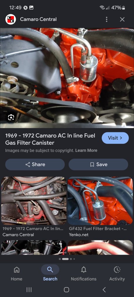

Just trigger it off the r terminal on the starter while the starter is engaged the transfer pump would run it would only take a few seconds to push liquid fuel to the main pump. Liquid under pressure raises the boiling point,liquid under vacuum lowers the boiling point,that is the reason we use pressurized cooling systems. And it's the reason we pull vacuum on air conditioning before charging,the vacuum boils the water out of the system. The way the return style pump or filter works is the fuel is constantly moving instead of deadheading at the carb. The cool fuel from the tank is constantly being pumped through the lines the hot fuel in the lines is forced back into the tank to cool. If you go with a 3 line filter the outlets should be pointing straight up.
also its not trying to shove more fuel at the carb than it can use, thats just needlessly pushing and adding heat
