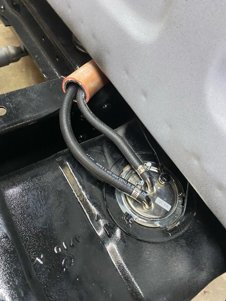

Where do those two lines go to from the tank, one obviously goes to the carb. Is the other one is a return from the pump or does it go to a cannister (or open air)? If it's a return line, then you need to be using a vented gas cap.

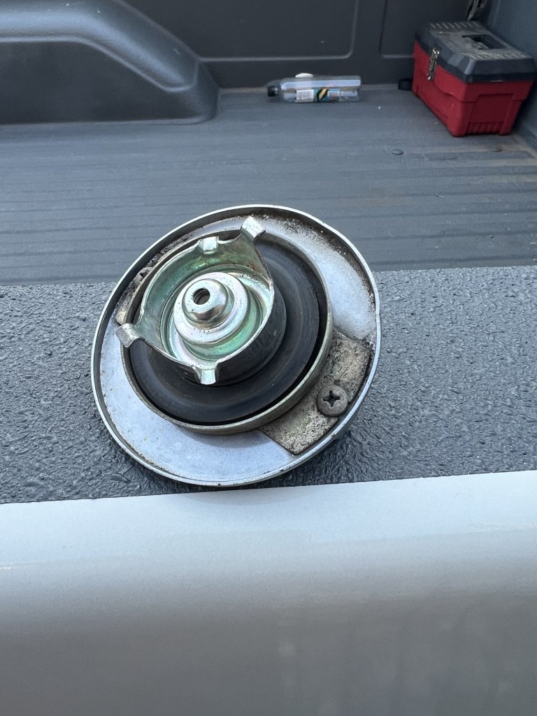

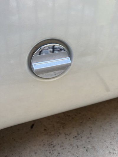

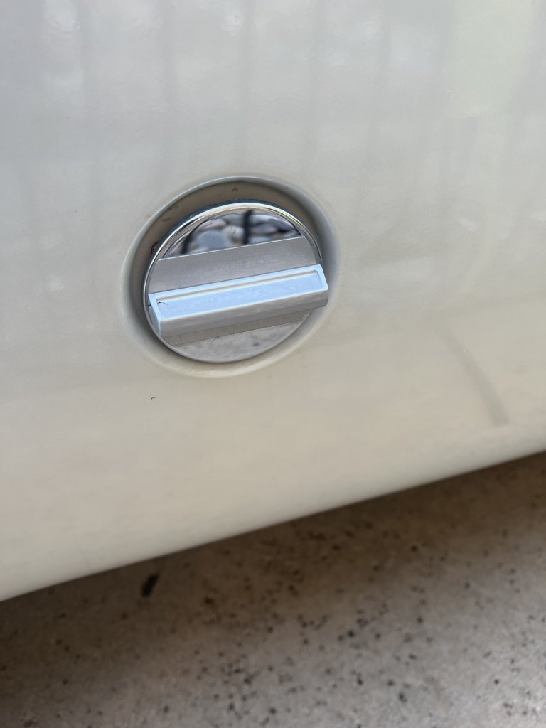

I can’t say we ever really looked actually. I’ll see if I can look today. Cap has the hole in base and side so I’m thinking it’s vented however the issue E told me about the other day May indicated cap is bad? Thoughts?

I was having a similar issue. when it got hot here (100+) I could shut the truck off and hear the tank make that "popping sound" when metal expands/contracts. New tank, recently converted to EFI. So one time I looked under the truck and could actually see the tank was expanded in the brackets. wow, so I loosened the cap slightly and it blew hot air out for a good 15-20 seconds! I was dumbfounded. So I did a bunch of research and discovered that "vented" caps are only vented one direction. They let air in but not out. But that wasn't my issue (or possibly yours). I plan to just drill a small 1/8 hole in my cap but have been too lazy. I have been keeping the cap loose enough to keep it from sealing and eliminated the problem. Apparently, the cannister does not have enough capacity to absorb two 20 gallon tanks worth of expansion which befuddles me. I have tested the valve on the cannister with a vacuum pump and it works as intended yet the tank still builds pressure.

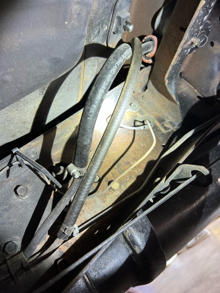

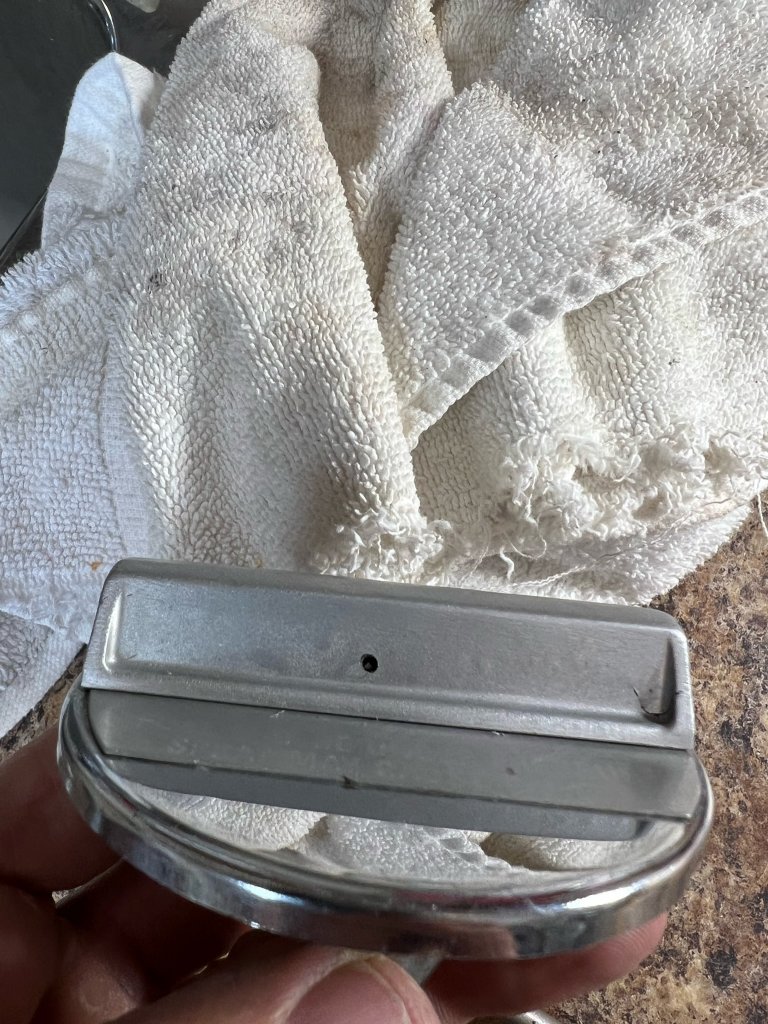

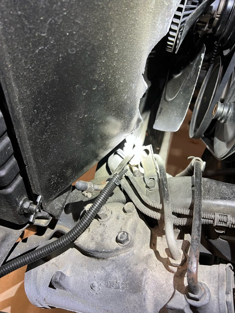

Well, drilled a small hole through cap and a small vent hole on cap handle. Traced the lines from gas tank and lo and behold, we found a line that just ends on drivers side by the brake proportioning valve. The line was just cut and not capped when E bought truck. One time last year when it was parked nose downhill we noticed what looked like transmission fluid draining out of it so E put the cap you see to prevent whatever it was from draining. E never followed up on it at the time.
So our question is, on the 1976 C10 with 350, did the charcoaled canister mount on the front clip or on drivers side inside fender wall? I can get another canister and attach it. I assume that we just use a vacuum port off the carb to complete the system?

That's the vent. Mine has the same. The original line would have gone to a rubber hose that would have gone to a vapor canister mounted to the core support on the driver side there. The picture of your sender shows you have from left to right in the picture, fuel feed, fuel return, fuel tank vent. If you aren't going to add a charcoal canister back in there, I would add some fuel hose that goes up to the top of the core support and then loops all the way back down to the bottom of the core support and then put one of the wobble vent valves that will keep any water from going into it. The big loop up to the top should keep the fuel vapor under control and still let it vent out any pressure if it needs to.
