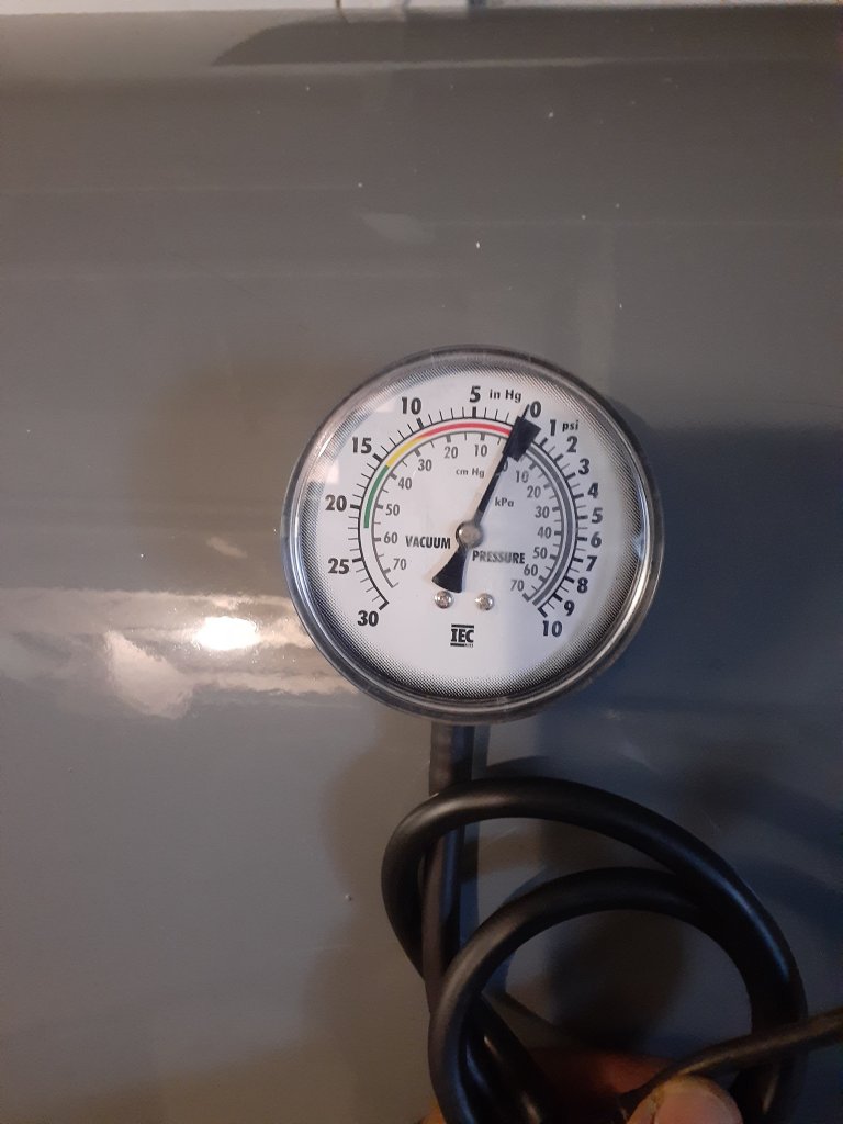

I had a similar issue with my 350 after I rebuilt it hard to start and idling too high approximately 1300rpm. I had to get electricity to the electric choke and that helped with starting. I had to go left then right gradually with the high idle screw (left facing the engine bay) and then the low idle screw (opposite side) while listening to the engine purr down to approximately 750rpm. I had a vacuum gauge while doing this. Went from 13"Hg to a more comfortable 17"Hg.
