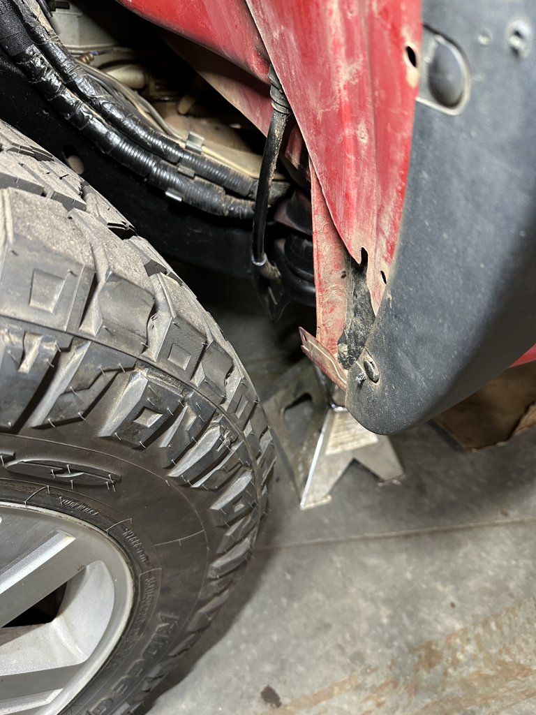

Then moved onto clearancing for tires. In the past I've never run anything larger than a 33" tire (295/70/17, 305/55/20s) on these trucks which all physically measure between 31.5-32". I usually could get away with bending up the tab on the driver's body mount at the rear and trimming the plastic inner fenders. But I've also run spacers before and had to trim alot cuz of the scrub radius. These 35s measure 33.5". I probably wouldn't have rubbed except maybe hitting a bump while half turned but I didn't wanna chance it. Plus if I decide to run spacers or wider/wheels and tires, I can and won't have to worry about it in the future.
This is at the rear
And this is the front at the valence
So this is the main concern. I did what's called the "NorCal Mod". We're gonna bend that horizontal tab down and cut/bend the vertical piece, then bend up the lower tab back up and it'll go further back, giving another inch or so more clearance

Then make a couple slices
Beat it over with a hammer
Then beat the bottom back up. Not pretty but it'll do the job. Looking at it after the fact, I probably shoulda just cut the vertical piece off and then I could've gained more room. I can always go back and do some more if need be
Then some paint so it won't rust

Same thing on the other side
Then just nicked the corners off the valence and trimmed the front overhang of the inner fenders. All I need to do now is trim the backs of the inner fenders a tad and secure them to where I folded the metal back
