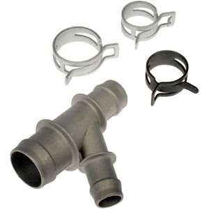

I should have mentioned before you stabbed the motor back in. You want to replace those plastic heater hose connectors on the firewall. They are known to break and dump all your coolant out before you even notice something is wrong. Use genuine GM plastic connectors. Or Dorman now makes metal replacement fittings. But DON'T use the Dorman plastic ones. Just good prevenattive insurance. Would be alot easier with the motor out fo the way. There is also a dorman steel "wye" replacement for where the hose mounts to the water pump.
Here are some links for examples, make sure to match your vehicle info/hose diameters for the right ones:
