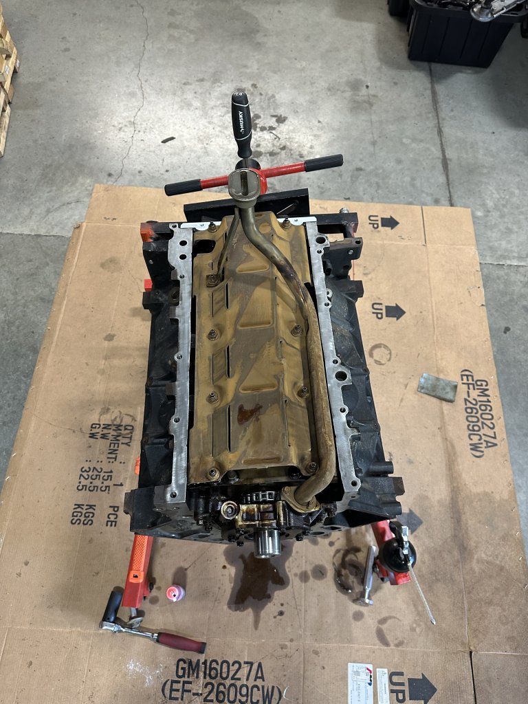

Started with just an assembled bottom end from yesterday…
Then added the windage tray and pickup tube with a fresh o-ring
Took extra time to make sure the rear main plate was aligned properly, made a small adjustment from yesterday
Same for the front, used the special tool and the balancer

I’m taking no chances lol
Pretty darn happy with that alignment
