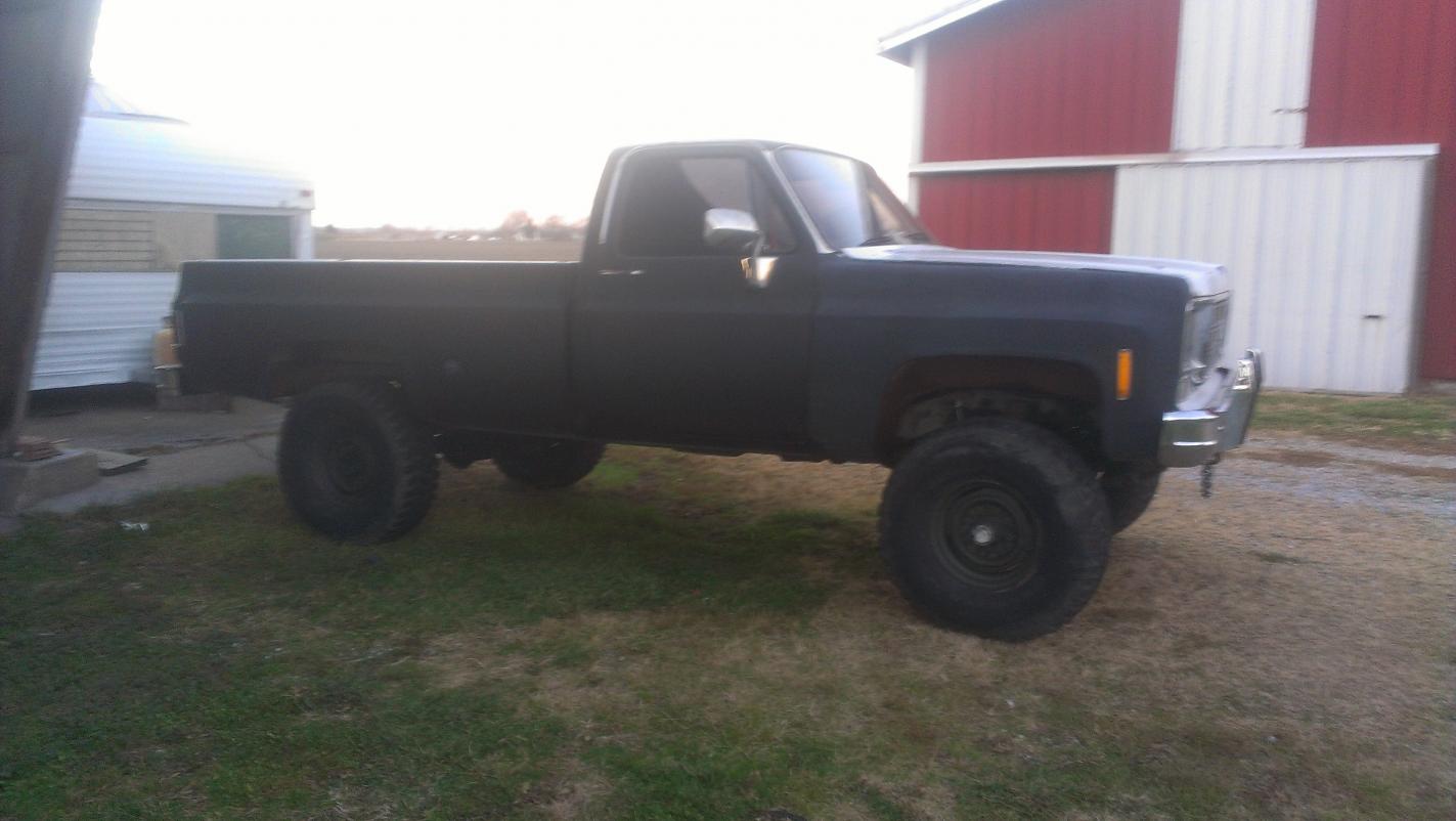

Heres mine 78 k20 Dana 44 14bff. 4 inch lift 37x12.50x16.5 Goodyear mt hummer.
