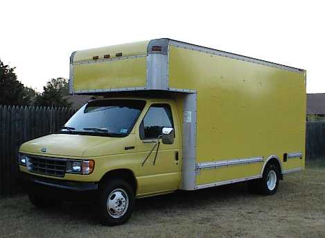

Yeah, I say remove the hood, be cautios, and it can easily be done with a hoist without removing the front of the vehicle. Now in a Van, no choice. I am not looking forward to if I ever have to pull that 460 out of the 93 E-350 Box Van. Oh hell that will suck hard core.

NO, this 460 isn't coming out of this cab. Its gotta come out the front I'm sure.
I have heard in some vans they come thru the rear slider door, but that's not gonna happen here, and I know that 460 won't come thru the side passenger door.
