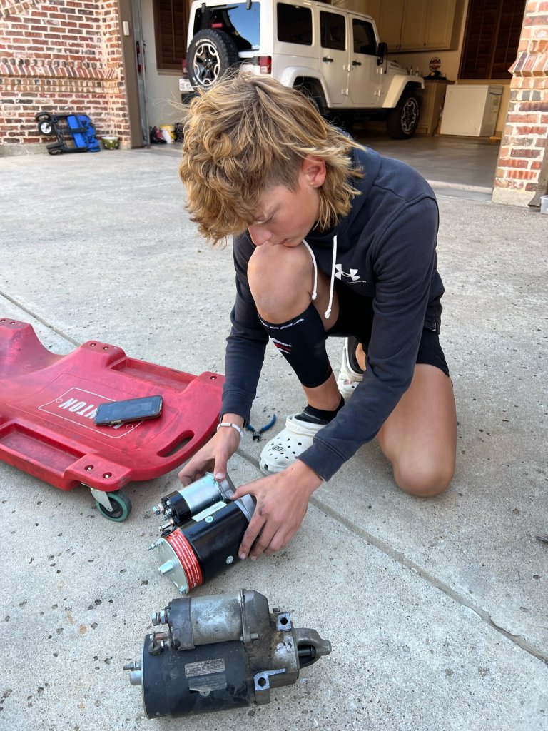

@PhotonFanatic and @rusted nuts < we are having that same issue on and off at this time. I realized we did not have a good ground engine to frame and picked one up yesterday hope to get it on this weekend. It sounds exactly like your situation and Easton just put a new (guess its reman) starter on it I would say 6-8 months ago.
Ill drop a note back after new ground is on and see if that’s it.
