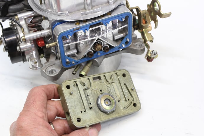

A link that tells you how to check the power valve
Holley has a page telling you how to pick and fine tune the power valve.
Here.it is.
