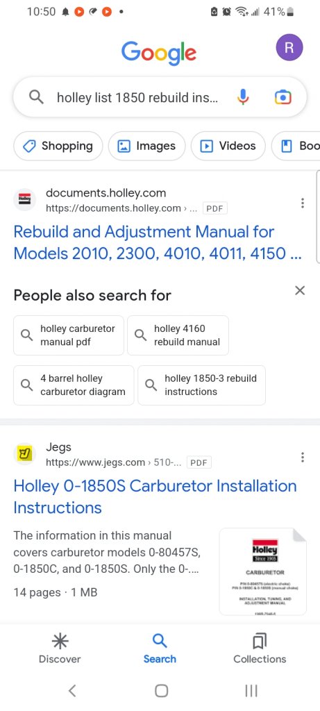

I can't link this I guess because it's a pdf anyway instructions from holley I assume everything you will need to know. I only skimmed it. Also a link to the correct holley brand carb kit. Although that ship may have sailed.Are you sure you even got the right kit?

Stock fuel pump, I stopped the fuel supply by using needle nose hose grips with electrical tape wrapped several times around the end, then let the truck stall. The primaries were pretty empty with a little seeping around the bottom screws, I didn’t take the secondary bowl off I don’t know how to tell if it’s empty other than the sight plug but it was way over full I need to get fuel out of it. I think I can get the primary side to adjust out fine, how do I know when it’s as low as it can get? The secondary side is turned in probably 5 rotations. I don’t want to turn it in too far and I can’t get it back out with the nut. @Ricko1966 i don’t see 1850 on the list of models for that kit, so never touching a holley prior I wouldn’t assume it to be for an 1850. I ordered a walker products set the second time, I’ve had good luck with walker and quadrajet’s previously. @SirRobyn0 i have no issue taking this carb back off after I found it easier to take the primary bowl off to access the nut by the throttle linkage. I didn’t have any issue with the quadrajets other than getting the linkages to all play nice when putting the top plate back on, occasional struggling getting all the needles and rods to line up, so I know I’m capable. I got an air compressor for christmas from my mom, but I’ve got no way to power it out in the barn lol. I’m going to hobo freight and lowes later today when I go to Murray to get that ls. I’ll see if I can find a can of that compressed air I’ve seen it before. I need to find some pneumatic wheels I can put on my cherry picker so I can actually use it. I thought I had everything adjusted good the first time with the floats set level with the bowl upside down. And the idle mix screws 1-1/2 turn out. For those screws, is the seal a plastic piece or an Oring? I used to take pictures as I took stuff apart, how I did drum brakes for the first time. I don’t have anyone in person that could even tell me the difference in a c30 and a k10. I only have one friend that’s even somewhat familiar with vehicles and he’s a Ford guy.. first start on his 302 it ran like crap and he couldn’t figure out why.. he didn’t have any vacuum lines ran or capped.. so that’s what I’ve got. If all else fails I’ve got about 16 other old holleys, probably 10 quadrajet, and after the ls swap I’ll have a good edelbrock 1405 off my daily lol or holley sells reman 1850 carbs for around 250 aswell. I know I can get it going without a doubt it’ll just take time, it took almost a year for me to get my 78 to the point I thought it was good enough to drive. What would the adapter do? It’s got an edelbrock intake I noticed. It’s got the open square bore instead of four independent holes.
