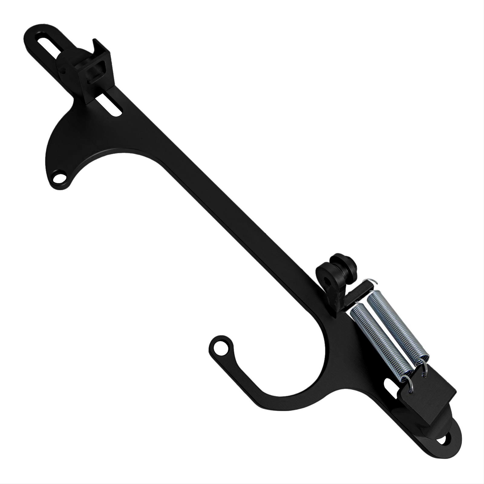

Is there another kit? Something easy I'm hoping. I found another obnoxiously large one but yet again utilizes the mounting studs that still probably wouldn't work.

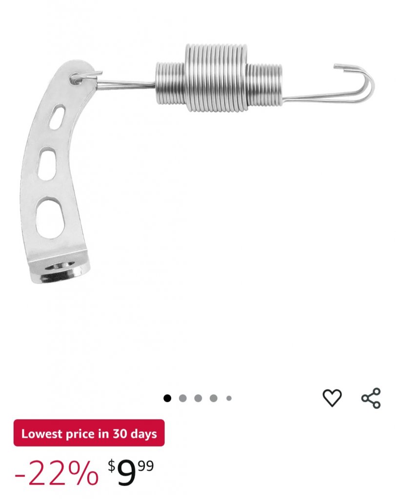

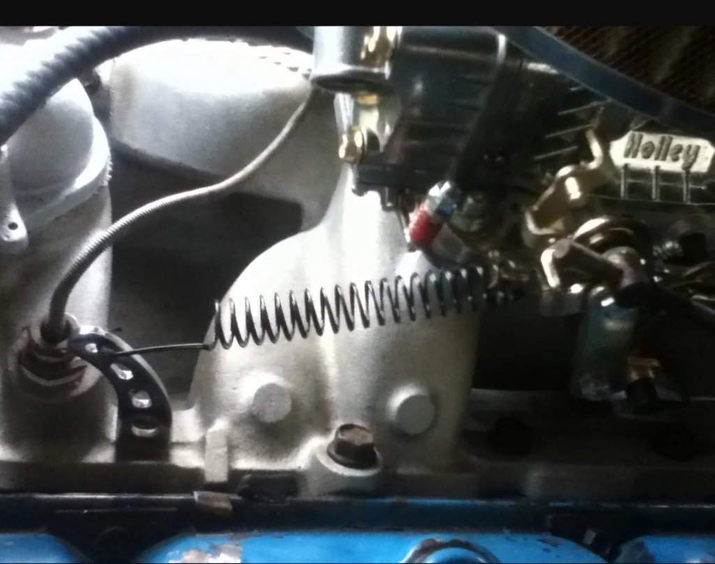

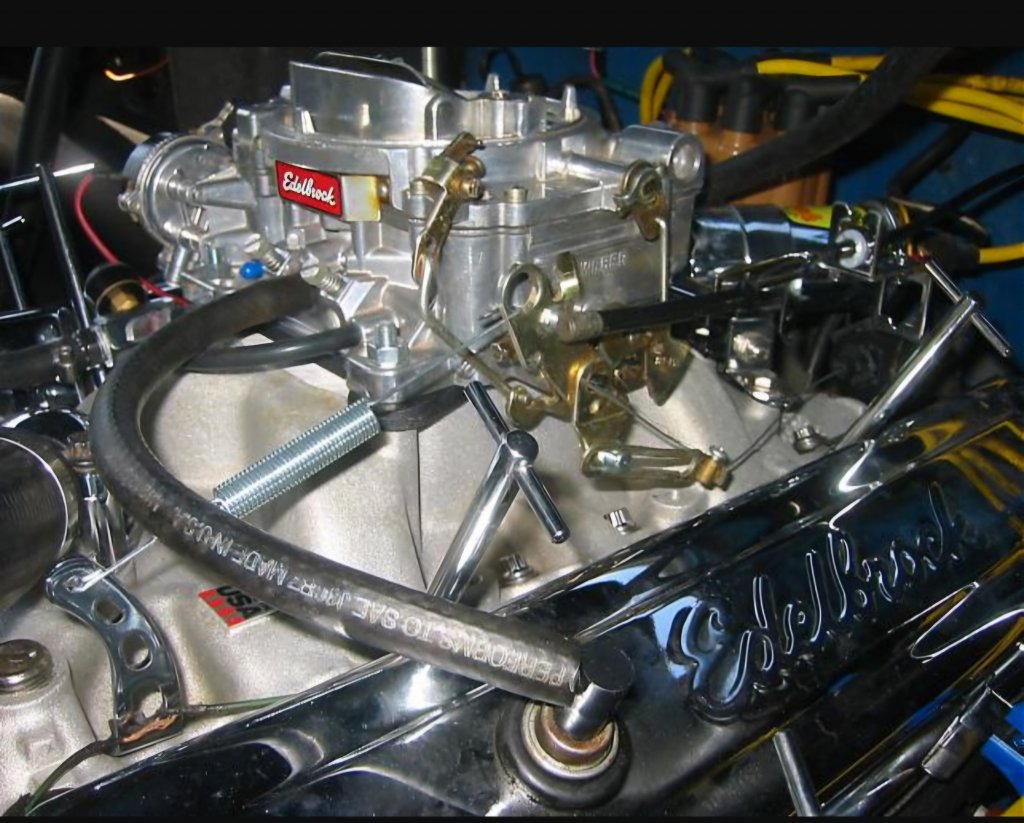

For stupid simple,and cheap I like these. 2 springs 1 as backup and with this arrangement the springs are pulling the cable forward the cable is pulling the springs rear ward the carbureator linkage is just along for the ride,so throttle shaft wear is minimized. Best would be cable andvsprings being pulled forward and backing a straight line. If the cable and spring both pull towards the rear there is constant pressure on the rear of the thrbottle shaft bushing. That's the reason so many quadrajets have worn out bushings.
