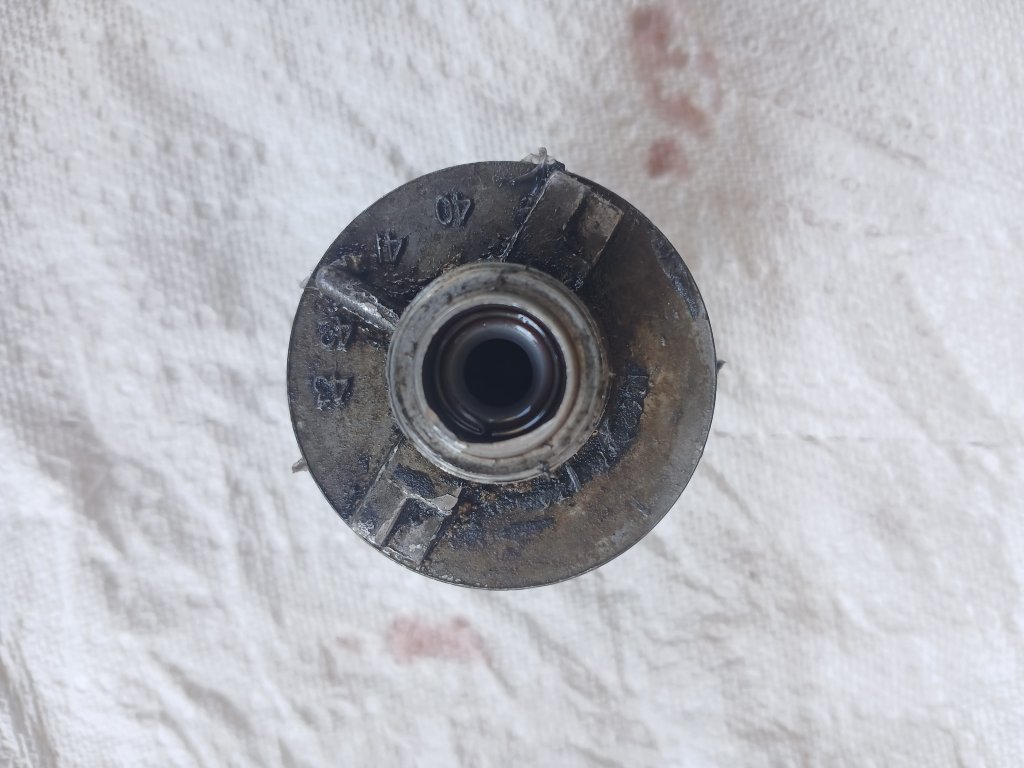

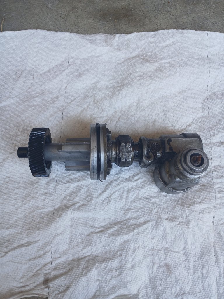

Hey guys, new poster, long-time lurker here. Just a little introduction, my current 87 long bed with 305 and TH400 is my second square. My first square and first vehicle was an 87 short bed which eventually sold.

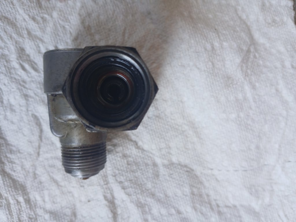

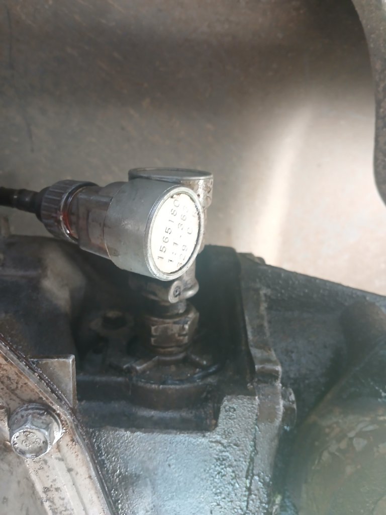

I had a fluid leak on the driven gear housing on my TH400 and have a few questions. I've never messed with these before. The fluid was leaking out where the cable housing threads on. I found a seal/o-ring kit linked below for the gear housing which appears to be the correct one. However the previous owner had an adapter installed on the gear housing. Can anybody help with finding the o-ring for the adapter? Or could I do away with the adapter if I find the right gear? The shaft on the gear was broken, so I'll need to get a new gear anyway
LINK TO SEAL KIT ON AMAZON
Part number on the adapter is 1565180
Any tips or things to watch out for when putting it back together? The previous owner had some kind of sealant around the large seal. Is that necessary with a new seal?
As stated I've never messed with these before so any help pointing me in the right direction is greatly appreciated

In the housing that goes into the transmission, there is an o-ring around the outside. Replace that and just wet it with some oil. No sealer is needed . Putting some one just makes a mess. Inside that same housing is a tiny little lip seal. These leak and will cause fluid to come out of the cable fitting. Easy to replace. Just make sure you have it facing the right way otherwise it will leak like a sieve.
The adapter,I am not familiar with but it looks to me like a 90 degree adapter so the speedo cable won't be kinked. If the transmission speedo housing is leak free then that adapter should be ok. Someone else more familiar may have more info on the 90 degree adapter.

Appreciate the input! I'll go ahead and order that seal kit and new gear and put it back together.
If the old o-ring on the adapter ends up leaking I guess I'll either need to take it in somewhere and try to match it up or look for a new adapter. Can't find the o-ring for it anywhere online

Yeah that's for the speedometer housing. I was looking for the o-ring that goes in the adapter, however like I said I will put it back together with the old one for now and see if it leaks
